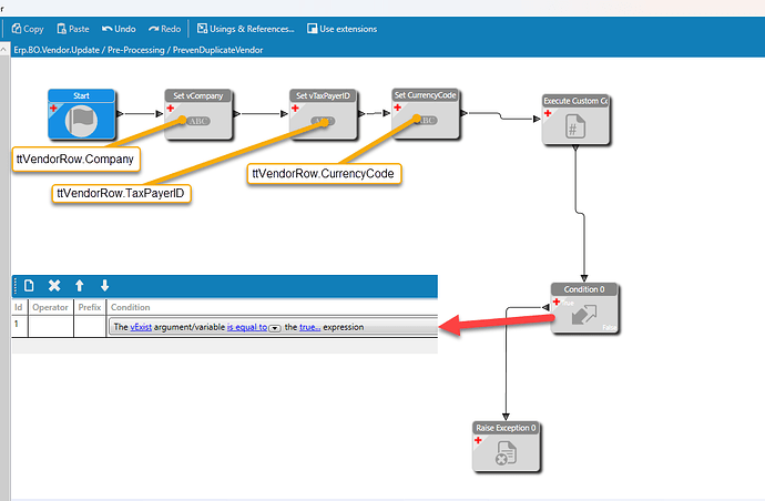

The idea is for a vendor to be unique, considering the fields Company, TaxPayerID, and CurrencyCode
Create a BPM (Business Process Management) as follows:
the custom code is:

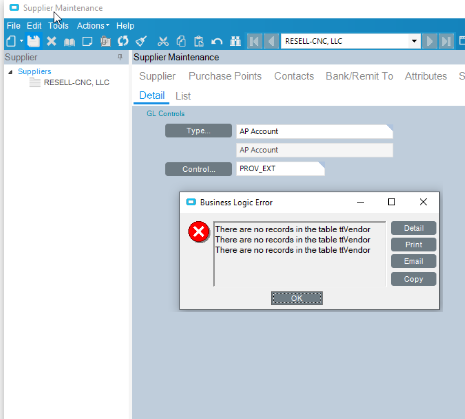

The exception should be triggered, but it is firing when a record is added, updated, or deleted.
How can I prevent this and ensure that my records are not duplicated?
Am I on the right track to execute this BPM, or am I completely wrong in what I’m doing?
