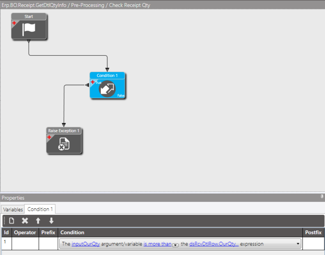

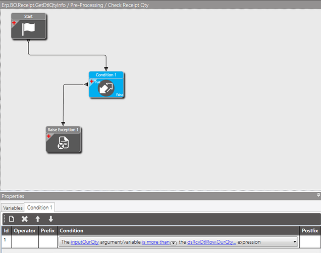

I’m following this post : Prevent Over Receipts for a PO Release - #5 by ckrusen
and created 2 BPMs to stop the user from over receiving a PO.
The BPM is working as expected when the user add the receipt line by line.

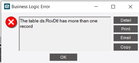

However, the user will hit the exception “The table ds.RcvDtl has more than one record” when they are doing mass receipt and trying to change the receiving qty to more or less than the PO qty.
How do I resolve this ?
If you have multiple records then in my experience you have to use a custom code block to iterate over each record and apply your business logic to each.
foreach (var RcvDtlRecord in ds.RcvDtl)
   // Apply business logic to check for over receipt here
   // if (inputOurQty > RcvDtlRecord.OurQty)
   //     throw new ArgumentOutOfRangeException(RcvDtlRecord.PackSlip + " " + RcvDtlRecord.PackLine + " had qty of " + RcvDtlRecord.OurQty + " which user entry exceeded");
Though as mentioned in the other post - it’s probably better to leave this as a warning to prevent issues further downstream.
