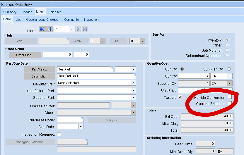

Wouldn’t enabling the ‘Override Price List’ checkbox accomplish the same thing? Or would it just go to zero?
I’m not aware of an override price list on the PO side, just on the Sales order.
