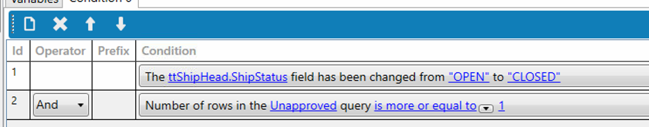

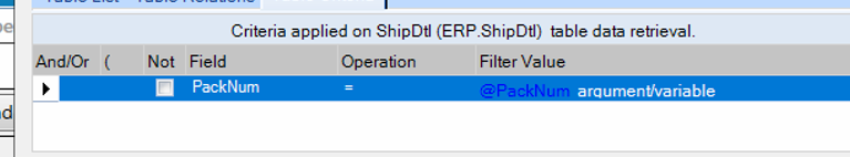

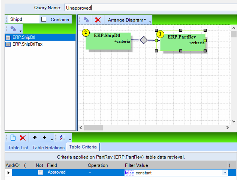

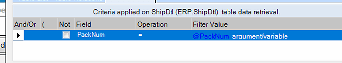

I do this on a Shiphead data directive when the pack is going from OPEN to CLOSED. If they can’t close it they can’t ship it.
My conditions are all in code, but if you added a numbers of rows condition with a exception widget it should work.
