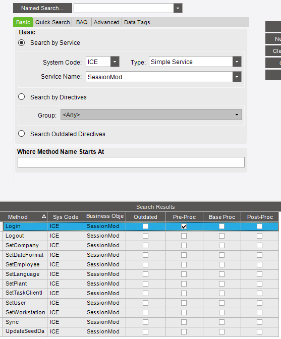

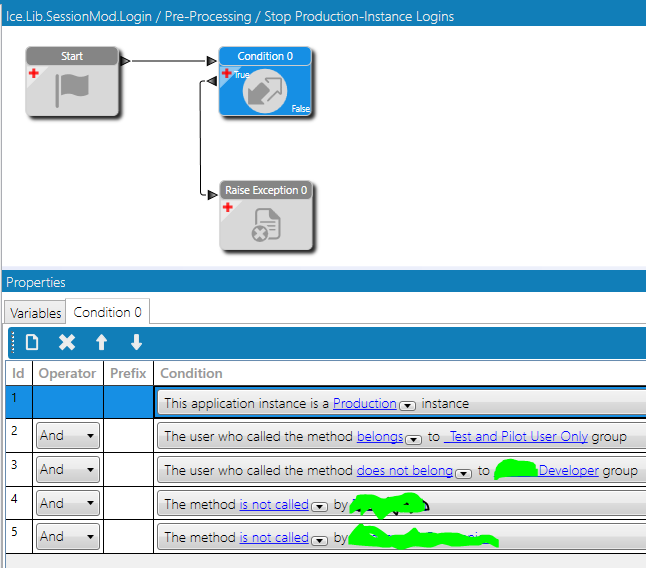

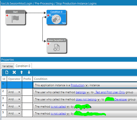

Here is what @LoganS and I did.
Found the right method directive and built a couple of conditions as a safety to ensure we don’t lock admin accounts out
