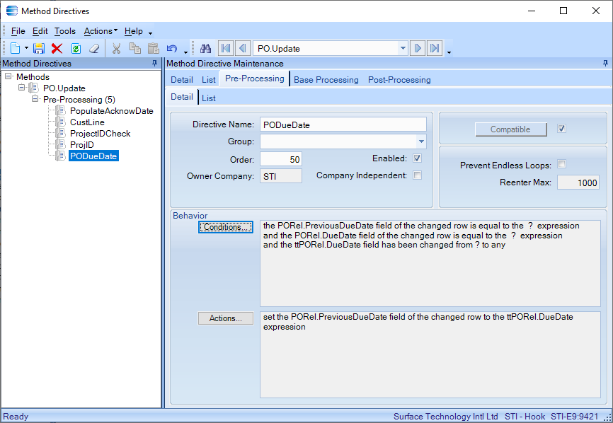

I am only wanting to do this when the release is first created so would this simple BPM work?

I tried the following but does not seem to work -
Should the condition be added row?
Try Added Row.

Tried added and that does not work either.
Hmm
