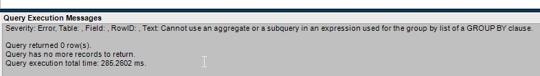

I know this is an old post, but I have another question with this technique. A few time now I have run into where I wanted to use this to add something to an existing query that has aggregate functions in it. To get around it, I make the top level into a sub query and bring through all of the same fields, but since it’s been grouped and summed a level below, it works. The problem is, this query is already in place in a dashboard so doing this means I have to recreate everything. Is there a way to get this subquery calculated field to work with a top level that uses aggregate functions?
edit: never mind, I figured out I just had to make sure that the field that I was tying the mini sub to was in the list in the top level. I had the job number from the JobProd table in the field, but I was tying it to the job number from the JobHead table. I added the JobHead.JobNum field into the top level and it works fine. Now I don’t need to redo the whole dashboard!

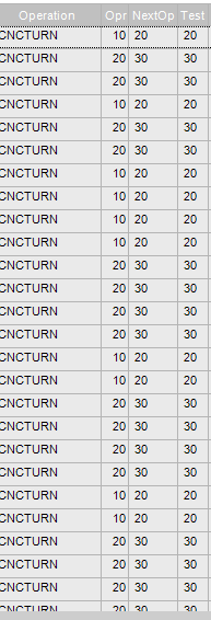

Sorry to bring up an old thread, but I’ve been working on something similar to pull the previous operation code but for some reason it keeps pulling a random operation instead of the next sequential operation. However when I try to pull the operation sequence, it pulls the next sequential operation number.
Has anyone had success with this?

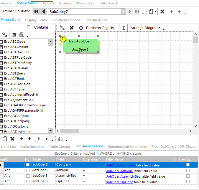

I’m actually reading through your post on formatting right now, new to this forum
So you have the op code is greater than, so you will need to order your subquery ascending and then limit to the first row. Did you do that?
No sir, would I do that in a calculated field?

Nope, for this specific case you need to go the the display fields tab, then there is tab there for order (normally you can’t do this is a subquery, but since this is a single sub select you can). Select the opSeq to order by.

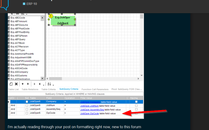

Also, I just noticed that you had the OpCode in your filter, you need the OpSeq for the order of the sequences. The OpCode is what the actual operation is.

This is the problem filter I am talking about. Having and opcode greater than another opcode doesn’t make sense. The OpCode, don’t inherently have an order (even though they might naturally have one in your business) so the filter for later opertations needs to be for greater than the opSeq. That’s why I think you are getting random operations back.
