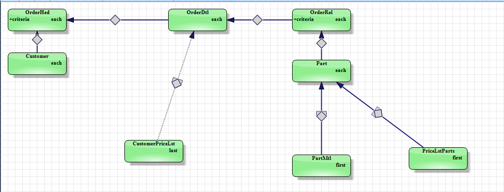

I created a open sales order report and was asked to display the price list used on the sales order so I added Price Lst to the table and now the field is displayed, yet only about half the sales orders now appear. If I change the PriceLst with Outer Join, I get all the sales orders but now nothing is displayed under the Price List?
Below is my Setup.

Try to use Customer Price Lst table. It might help.
It’s better but I am still missing plenty. What esle can you suggest.

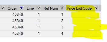

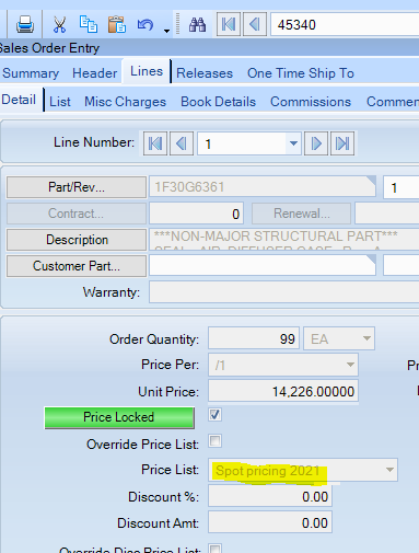

I have the price list on the sales order, yet nothing prints on my BAQ (See Below)
Thanks in Advance.

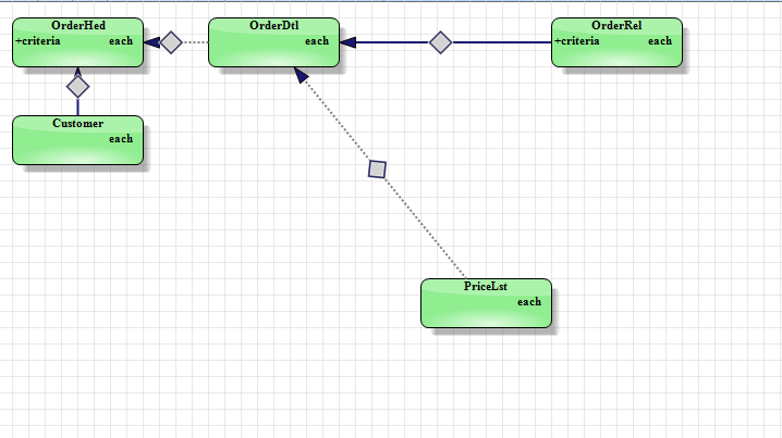

Hello I tried your suggestion, I got information listed but many codes but didn’t tie out.

You want the join to be an outer with OrderDtl.BreakListCode = PriceLst.ListCode
You can use field help to find the bindings you need.
