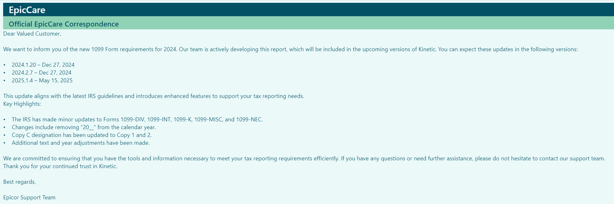

I was optimistic this year because Epicor sent out this thoughtful notification, which I don’t remember getting before, but the alignment is still off.
