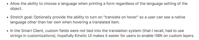

I am the lone voter for this Epicor Idea:
Improve the Internationalization Engine | Idea 4088
