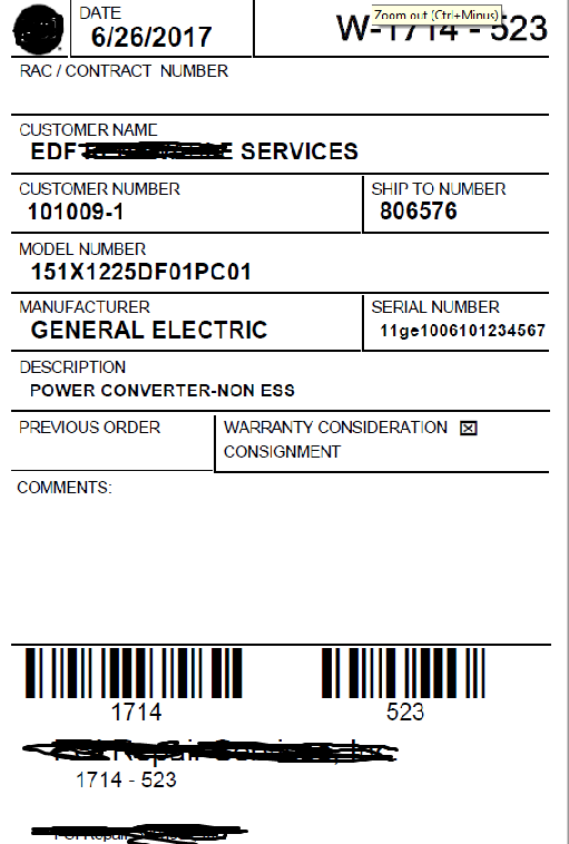

If you think you only need BT for one week, then I would recommend using SSRS. While it’s a bit tricky getting label size and margins right, it’s quite doable. Maybe easier then BT based on my experience.
We used SSRS report to generate a custom designed label which prints on an Intermec printer. The label is a 4 x 6 inches form. Its printed with a small company logo, graphic lines, characters and barcode.
