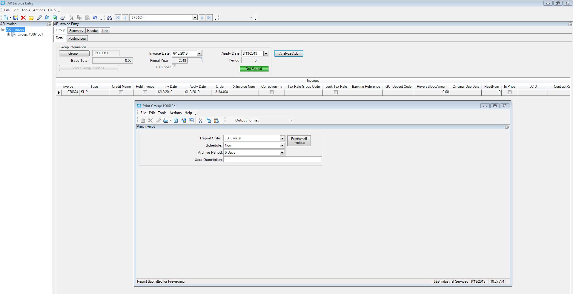

We are on Epicor 10.0.700.4 (I know it is an older version) and we have a unique issue. Our accounting department has a screen that contains a print/email invoices button and upon them clicking this button and processing things it causes Epicor to hang and eventually throw a crash pop up where they have to close out of Epicor and start the process all over again. I have tried this on my machine and the user/accounting personnel’s machines and same thing happens. I have tried it on Win 10, Win 7, and it still occurs regardless of OS. Additionally, I have updated the print drivers/firmware on the printer that usually prints these out and it still happens. I am attaching a screen shot and if anyone can help it would be greatly appreciated.

Yes sir, this is a customization. We get to it by going to Company Name > Financial Mgmt > General Ops > Accounts Rec > Invoice Tracking. We then type in the invoice and hit the print icon or go to actions > print. From there, the screen pops up and there is a button that says Print/Email invoices. The email part works fine, however, the print portion does not.
This is only affecting one user on one machine. My boss, myself, and the accounting manager can all print using this customization.
Do you have any suggestions as to what I might look for? The person who created this customization is no longer here, and I am not a programmer at all.

Also, I just tried from another machine, and it did not work, however, I did it from my machine and the accounting mgr’s machine and it worked. I use Win 7 Pro SP1, accounting manager has Win 10 v.1803.
I should also correct my original statement by saying Epicor does not hang, but the print screen that is suppose to pop up stays minimized until I right click it in the task bar and select maximize. We use Epicor 10.0.700.4
