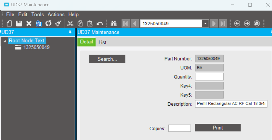

I have reached that point. The help requested from you is to know how I have to populate the UD37 table, if it is through Data or Method Directive and how I can do this?
I’m not sure exactly what your trying to do, but if you are using a BAQ to generate part data and want to be able to dynamically pass quantity and number of copies, why not define quantity and number of copies as parameters in the BAQ and reference them in calculated fields?

You can output the BAQ results to csv and probably read that from a bartender integration if that’s something of interest to you.
Alternatively you can build a bartender REST integration and send the BAQ json result set to the integration that can read it and parse through each record performing a print for each record sent…
