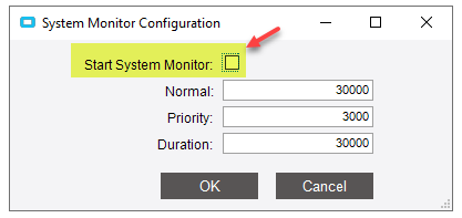

If you open the system monitor, does it then print? I’m troubleshooting a similar issue where as a security manager, when I open the system monitor, those reports printed by another user open in my session instead. My issue seem to be that even if I check the configuration check box to ‘Start System Monitor’ as enabled, it doesn’t retain it’s saved setting and the system monitor icon never shows up in the tray icon section.

Yeah, it’s happening to me too using a security manager account. Seems odd that this checkbox isn’t saving or starting the system monitor correctly.

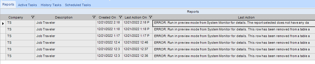

Geez, I just looked in System Monitor again and there are errors… History Tasks shows completed with no errors, but the report tab has errors. Can anyone help me to understand what these errors mean, they seem to be truncated so cant’ read the entire error…

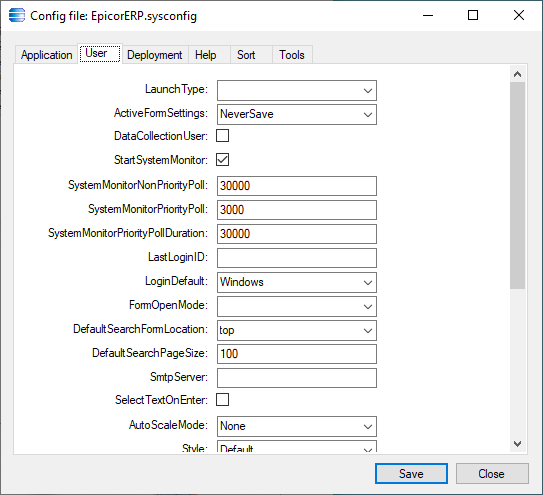

As far as the system monitor goes, when we initially deployed 10.2.500 (I think) it did not automatically set the flag in the config file to start the system monitor when Epicor opened. I have since corrected the config files that get distributed on new installations, but I also found there is a utility distributed on installation called ConfigEditor.exe in the Epicor Client directory that allows you to modify the config file. When you run it, you select the configuration you want to update, then go to the User tab and make sure the Start System Monitor box is checked.
This updates the config file and then the system monitor will always start on opening Epicor.
I’m getting the same thing as we speak (10.2.600) and wondered if you might have figured out what this truncated error message actually means?

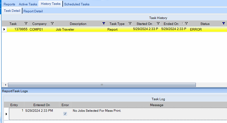

@EpiTommy Welcome. That message is no data, but previews can be other things. The History Tasks also has an entry for that report. If you move the Logs tab you can see the error and the log at the same time. Assuming you are a security manager and can see all tasks it is pretty easy to see what is happening.

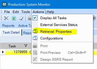

I also have all users set all four retrievals, so you can avoid the waiting for a report that has no records based on the filters set.
set all of these
split the log to another window and make the row larger.
