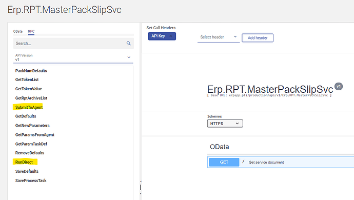

Yes. You can do it with REST.
Also, the System Monitor is what retrieves the report when finished. That’s why logging into Epicor brings it up. Using the RunDirect method would work but you might have to retrieve it with the ReportMonitor service as shown in this thread.
And you’ll need to go ahead and tell it that it printed, or it’s going to print again when the client is opened.
Let me look.
See this from your code, that is your pdf file data, You will need to print that yourself.
Also, you are using SubmitToAgent and then immediately checking for the report, instead of waiting for it.
Use RunDirect. Then it should be available when RunDirect Completes.
And if you keep using the dlls, you’ll need to remember to update them at every client update!
There is a few things more wrong with that code above too. :thinking:
I do this via REST.

I’ve just about got your original code fixed up.
I will try your suggestions and report back.
Thanks Kevin!
If you hold on, I fixed it for you :rofl:
