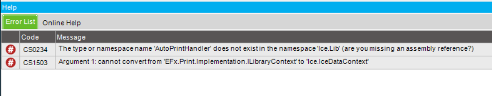

Here are the errors:
The second error (CS1503) is in regards to the line:
var reportService = Ice.Assemblies.ServiceRenderer.GetService<Ice.Contracts.BAQReportSvcContract>(Db, true);
Been trying to get this to work a couple different ways in the new Epicor functions but they all seem to fail with the “cannot convert from EFx.Print.Implementation” error so any help or guidance would be appreciated!

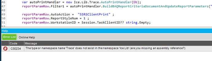

For the AutoPrintHandler use this - Note Ice.Lib.Trace
var autoPrintHandler = new Ice.Lib.Trace.AutoPrintHandler(Db);
Thank you, which assembly did you use? I didn’t find the Ice.Lib.Trace
Thanks!

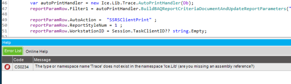

Thank you, that worked! The only thing I’m hung up on now is the Ice.Lib.Trace not being found in the function.
That was wrong it was in Ice.Lib. Let me grab the right thing and post shortly.

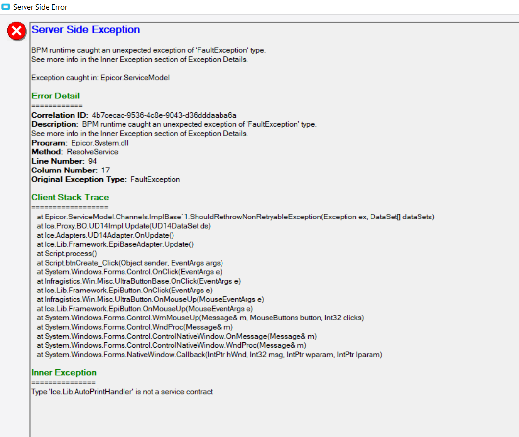

Thank you, that allowed me to compile and test the function but now I’m getting a server side exception when I try to call it where it doesn’t seem to recognize the AutoPrintHandler. Any ideas?
Yeah - so this will be a no go in a Function. The rest works good. I don’t have a specific auto print example so kind of taking a swag. I am reviewing now and think there might be a way around this.
@cschrempp if you are using a function you need to add the assembly into References > Assemblies
And use ErpContext() to replace Db
I had both of those assemblies added and tried your ErpContext suggestion but I’m still getting the error with the AutoPrintHandler.
