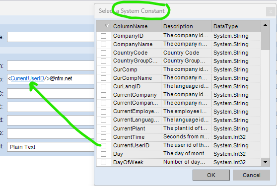

Another approach IF your Epicor user ID’s match your email addresses… you can ā€œInsert System Constantā€ and pull in the ā€œCurrentUserIDā€. Then just append to the value to complete the email address with your @whatever.whatever
Very true, but just in case they ever don’t linking back to the EMailAddress in the UserFile, I avoid someone not doing what they should and breaking it :slight_smile:
