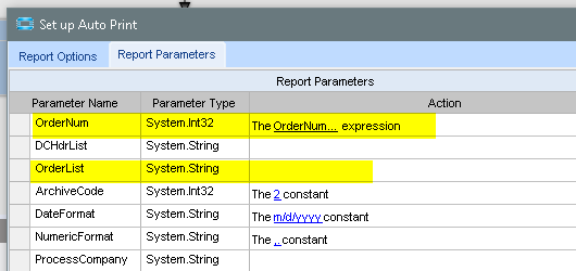

And FWIW - it looks like the QuoteForm printing was only ever designed to work on a single quote.
I took a look inside the Auto Print widgets available in a Data Directive, and see that the OrderAck printing can accept a single Order number or a list of orders to print.
While the QuotForm only accepts a single Quote number
You could do something to cycle through all the desired quotes (like a DD on a UD table) that passed the QuoteNum to the widget. But that would make individual PDF for each Quote. You’d have to then combine them yourself.

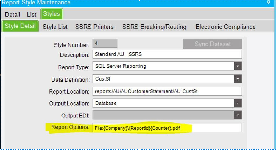

I think I might have misled you. You can use the Style options to specify the location of the PDF. Try taking out the \ betweenFile: and Quote
edit: Also change{Sequence} to {Counter}
I created a Report Style and added the following to the Report Option field:
File:{Company}\{ReportId}{Counter}.pdf
That file ended up as:
C:\EpicorData\Reports\manager\MC\SessionAudit00001.pdf

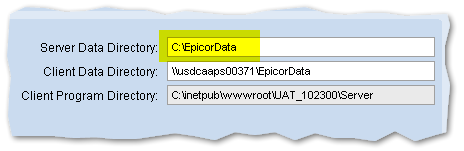

The C:\EpicorData part is from the System Agent setting:
The \Reports\<userid>\ is automatically generated at runtime
The MC\SessionAudit00001.pdf is from the {Company}\{ReportId}{Counter}.pdf

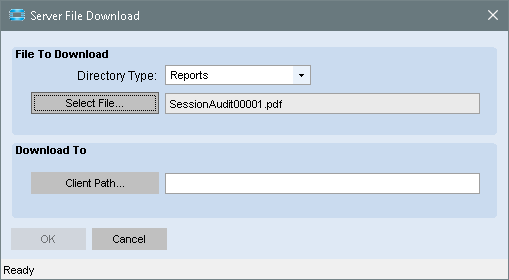

If a user can’t directly access that location on the server, then they’ll have to use the Server File Download program. Select Reports from the Directory Type, then use Select file to browse to the file.

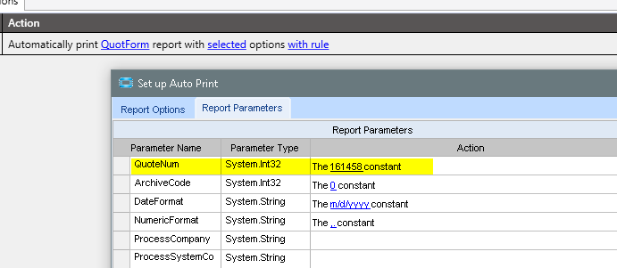

If you’re looking to do it without any code (which I always prefer), You could use a UD table to hold the quotenumbers to be printed. A DD on the UD table could detect a new record added, and it could use an auto print widget… The quotenum added to the UD table would be used to fill the QuoteNum field in the widget’s settings (see the screen shot of the post you referenced). Have the DD set a field in the UD to indicate it has printed.

The Auto Print widget for a QuotForm based report only accepts a single quote number.
