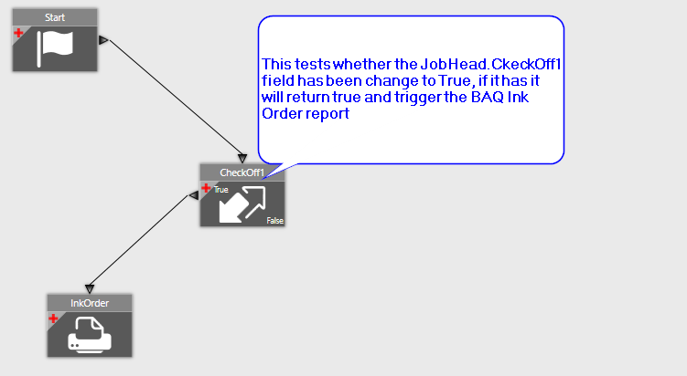

I need to print 3 reports: the Job Traveller, the Job Pick list and the Ink Order. The Ink Order is a BAQ report that we have written ourselves and that come out just fine, but the other two do not and they are standard SSRS reports. Is there a trick to get those to print out as well?

Can you share a screenshot of your Data directive please? I’m assuming your cascading the prints one after another?
Rob,
Good to hear you have one working. As Simon has pointed out, the reports need to run one after another. Essentially three similar blocks of code, each to run a separate report.

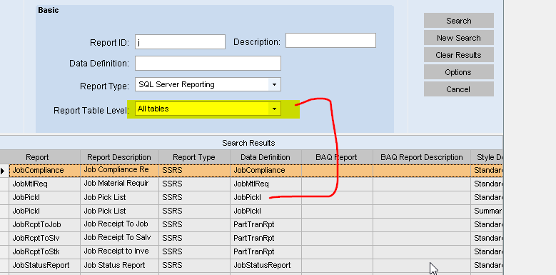

A point to note … The Pick List does not use the JobHead table. To select the JobPickl report, I had to use the “All Tables” \option when searching.

I’ve re-written the Job Pick report to be a BAQ report and put this on another Data directive that looks the same - that now works as well, but I don’t really want to have to re-write the Job Traveller as it is big and complicated and also it is embedded in Epicor and so We would lose that.
