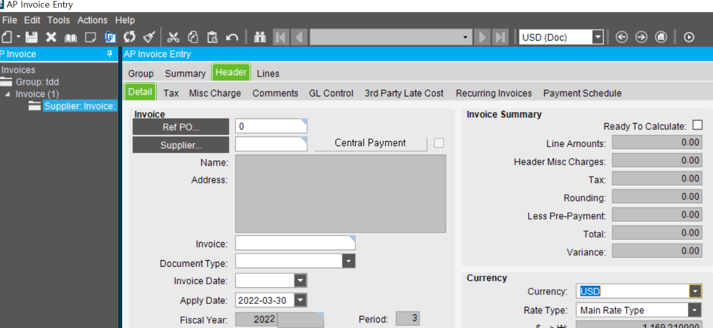

My accounting department asks for a printout of the AP invoice. The output of the AP invoice seems to be the AP Invoice Edit List.(There doesn’t seem to be anything else)
But the problem is that this print is only available until I post the AP invoice. After posting the AP invoice, the invoice disappears from the AP Invoice Entry and there is no printing feature in the AP Invoice Tracker.
Is there any way to print the AP Invoice Edit List after posting?

What I’m talking about is not the supplier-provided AP Invoice.
We fill it out in the AP Invoice Entry. When creating AP Invoice in AP Invoice Entry, click Print Group Edit List to print AP Invoice Edit List. However, after Post, the corresponding AP Invoice Entry cannot be opened, so it cannot be output any more.

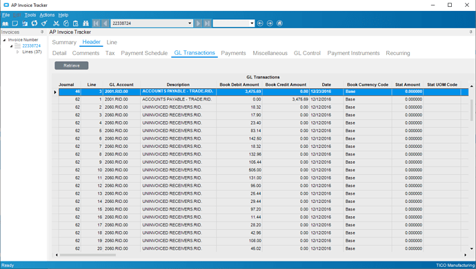

  2. You can, with much effort, get at that same info, after posting, in the tracker screens. See pic below. The tricky thing is that you get new entries in there that were not in the edit list - like the first row in my pic, when there is a debit to AP after the check is cut.
