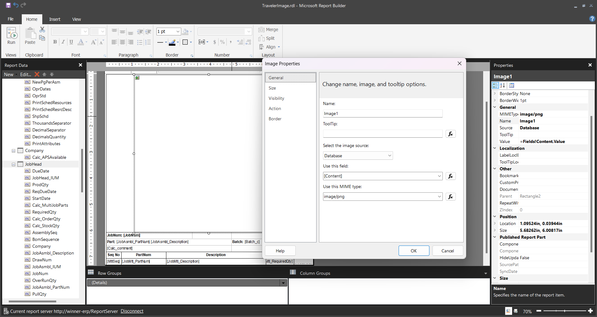

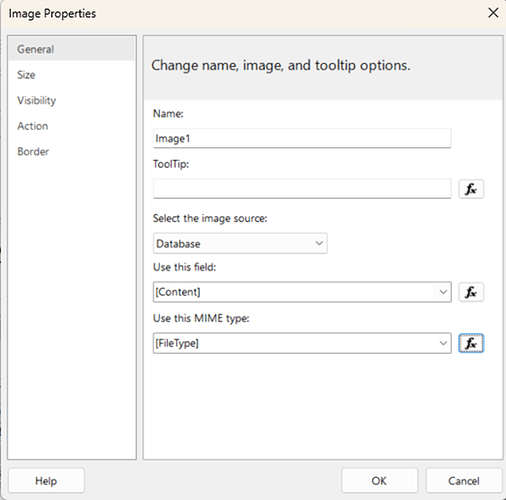

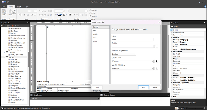

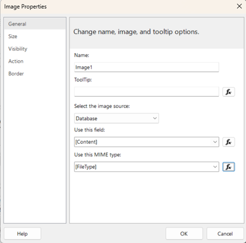

I have a question, how do I add the Content field to the report builder? How calculated field or query field? If is a calculated field what would be the expression? I don’t quite understand this
Pd. English is not my native language

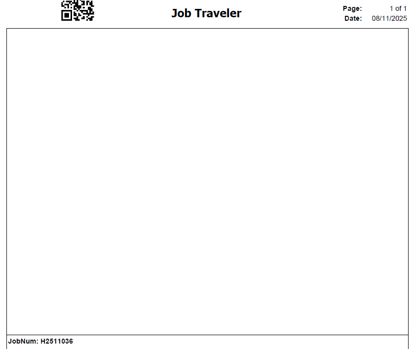

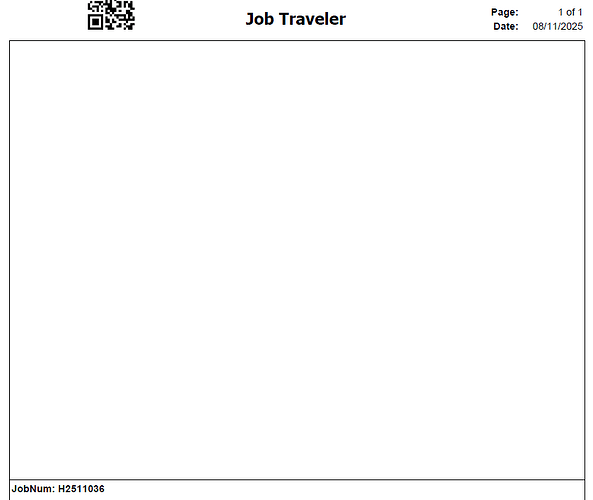

I followed your method but the image doesn’t appear.

  • Added Image to the report as follows:
    • Image source: Database
    • Use this field: [Content] – “=Fields!Content.Value”
    • Use This MIME Type: [FileType] – “=Fields!FileType.Value”
Is working perfectly for us. Try this and let me know if worked for you.
