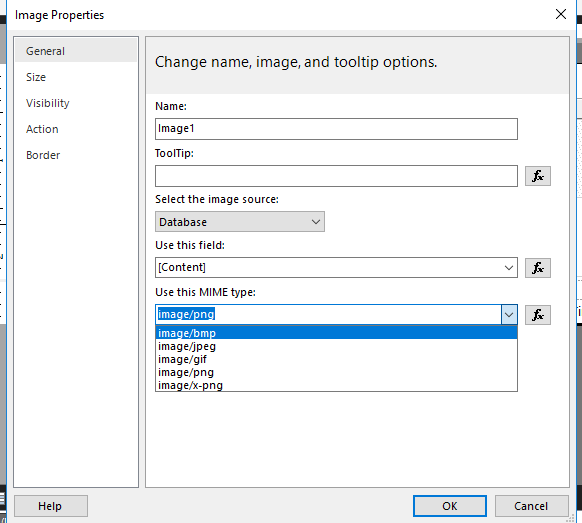

Add an image to your report.
Choose the Image Source (Database) and select the added Content field.
Finally, you must set the MIME type or you’ll just get a broken image on your report. So click on the Expression button for the MimeType. I made a formula for the various types that we might see but no matter how you do it, make sure it is set.
And you should be good to go.

Do you really need the expression for MIME Type? I just tested on SQL 2016 and it appears I can select any mime type and the image still appears.
Good question. I know you need A MIME Type so maybe the expression is not neccessary!
Without the MIME Type, I always get a broken image.
At least for the SQL 2017 Report Builder…
I am going to assume that you are using the ImageStore and I think for that you need to use MIME/Type if I recall, because it just throws a MemoryStream or Base64 at SSRS and by selecting a mime/type it knows how to decode it?
Pulling directly from Ice.Filestore.Content I tried all the MIME Types and they all worked. Using the correct type sounds better, so I’ll start doing that.
FWIW - The base ARForm uses an image from the dataset, and the MIME Type expression is:
=First(Fields!LogoMimeType.Value, "ReportImages")
So it looks like the MIME Type is (or can be) in the dataset.
