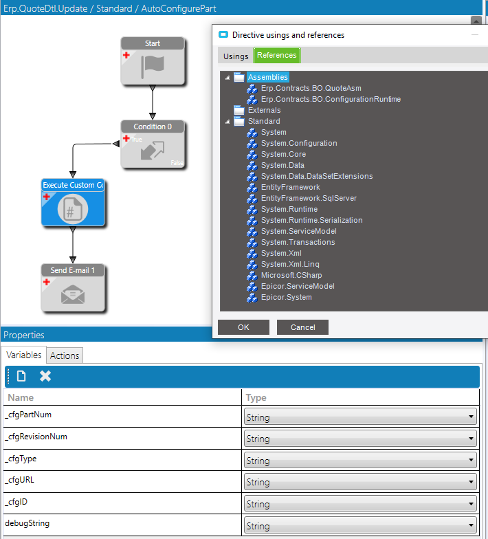

I created a proof-of-concept for this a while back when we were looking at building our own configurator on our website and passing the resulting parameters back to Epicor. The gist of it was to create a quote line with a smart string and then fire off the configurator’s own processes via BPM to run the configuration based on the values in the smart string. I hadn’t really played with functions yet, so it could probably be done there easily enough too. Feel free to build on this to bootstrap your own project.
Here’s a screenshot of the standard data directive on QuoteDtl showing all the variables and references:
The condition just checks that ttQuoteDtl.SmartString is present and that ttQuoteDtl.SmartStringProcessed is false. The email sends the result of the debugString variable (proof-of-concept, remember).
