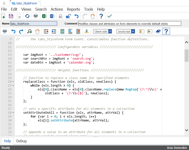

Gotcha mis-understood! We use… ARAS Currently (open source) with Service Connect to pass Parts, ECNs… to Epicor and vice-versa. Its web-based, runs in your browser. IIS App.
It is very customizable via C#, JavaScript, Forms… just like Epicor. It has its own DMT Tool, the db is SQL, you can create Tables, Forms, Relationships, Workflows… Probably even find 100s of plugins on github.
Just like Epicor you can modify C# Code, Methods within ARAS - or you can go to Visual Studio.

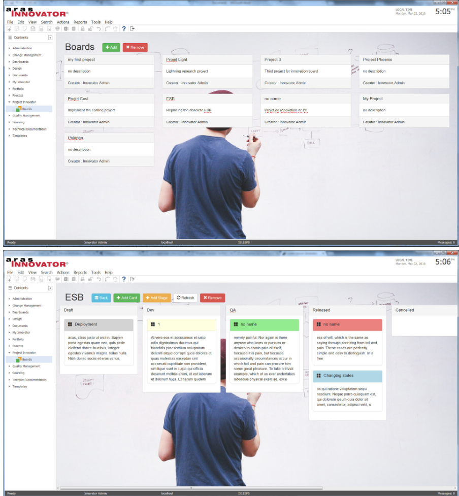

Like #Kanban Boards
