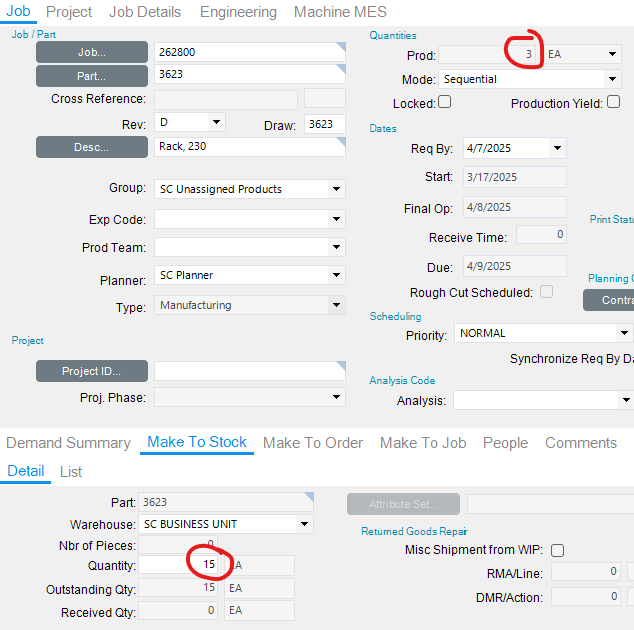

Production Qty vs Demand Link Qty mismatch
Does anyone know what causes the Production Qty shown in the top of job entry to become mismatched with the value shown in the demand link tabs in the bottom?
That is strange. What does the Demand Summary | List tab show?
I can’t tell you what it used to say because I already fixed it. I’m assuming it would match the value in the detail. The only way I know how to fix it is to delete the demand link and then add it back in with the correct quantity. How it gets off I don’t know. I found 9 jobs that were like this which were created in the last 1-2 weeks. They are all firmed jobs so it is something that is happening after MRP creates the unfirmed job.
Do you use Co-parts?
I was just curious if there was a Make to Order or Make To Job entries there. But honestly, I would have expected the 3 in the link and the 15 in the total with the difference made up from other demands. It is odd.
No, we do not.
