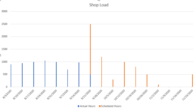

I like to visualize shop load as a stacked chart.
You can start with the full plant grouping labor by week, pushing all past due estimated hours to today.
In this example you can see the plant puts out approximately 1000 hours per week, but this week has a total of much more than the 1000 because of the past due.
Once the total is inline the same visualization can be used to see the load on the individual resource groups. If you load level by moving jobs to different resources then the visualization will work as you move jobs around.
understood Carson, i appreciate the feedback. this may seem like a silly question but are you seeing this data right from epicor or are you exporting to excel. i know epicor has a shop load feature that i have been trying to utilize with no luck. was just curious
I would normally do it in a BAQ report. It could also be done in EDD or probably a traditional dashboard.
For the example I posted I just faked a little data in Excel.
