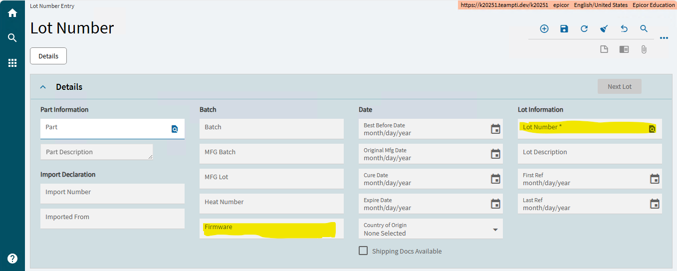

I believe some users here have used Lot control for firmware. You would enable it on the programmable component and then you would ALWAYS have to include the Lot number. The Lot table has a field for Firmware that might work for you.
