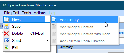

Curious … I hopped inside Epicor Functions Maintenance and I have no way of creating a new Library. Is that a feature unavailable to Cloud customers by chance?

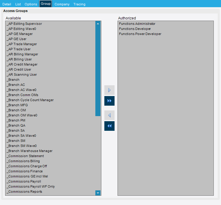

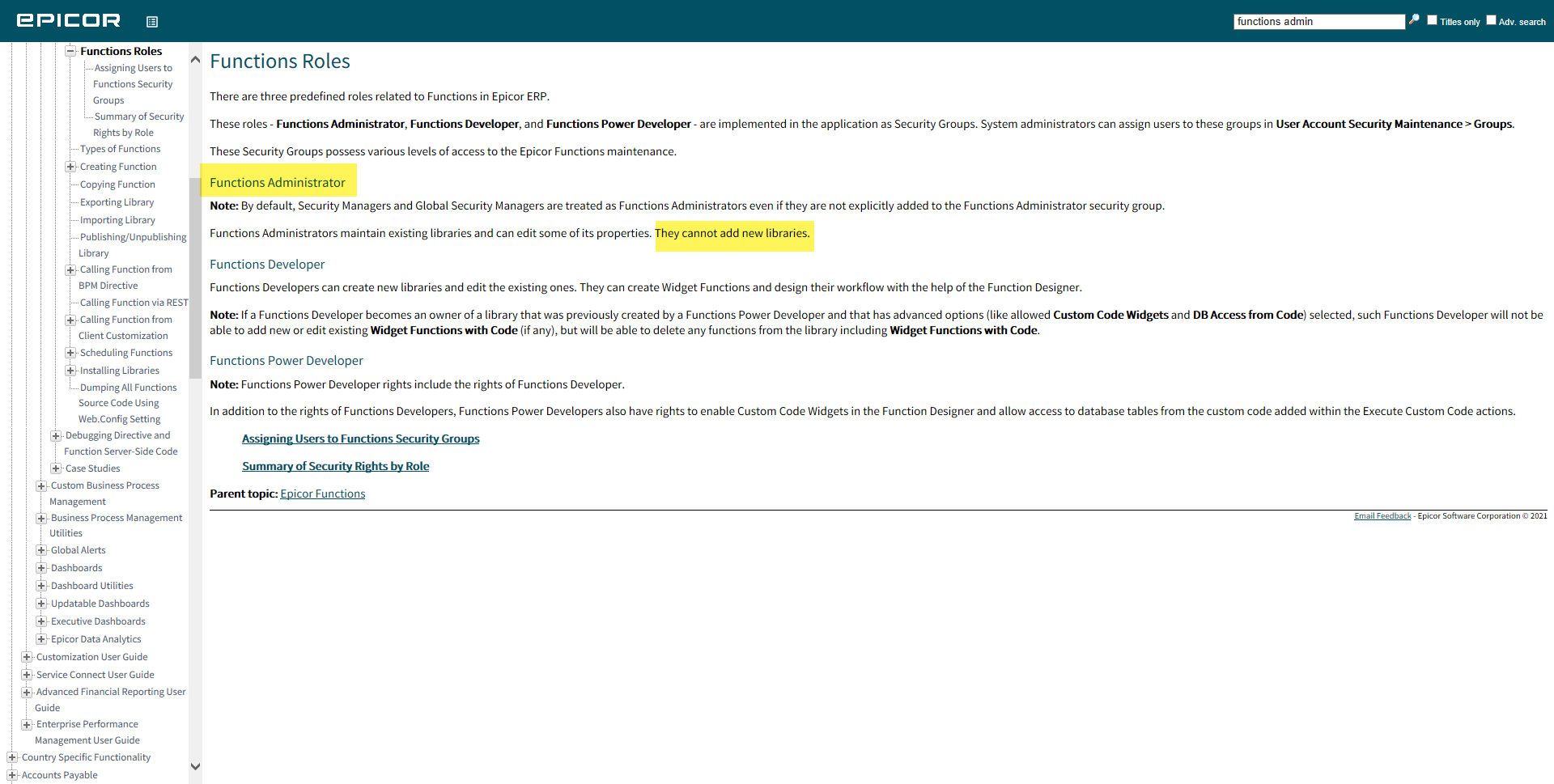

I assumed the Security Manager option was enough. I did add the “Functions Administrator” group to my profile and re-logged, but still no ability to add a new library. Am I being a dummy somewhere?
I usually add all 3.
I’m in! Thanks @hmwillett and @Randy
