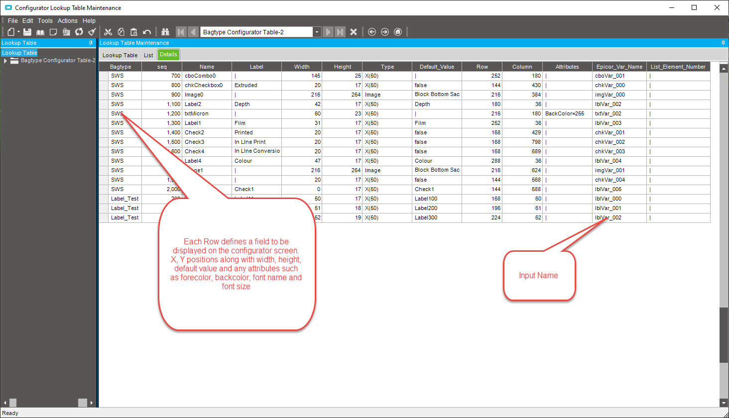

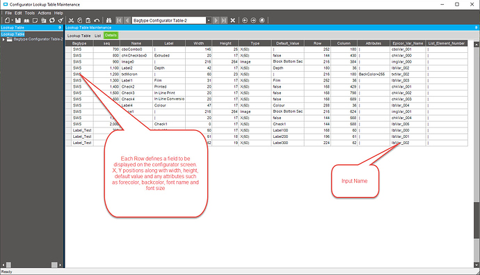

What I want to do and have successfully accomplished 80%-90% of, is to data drive the configurator display screens, in my case from a Configurator lookup file which holds all the row, column, length, format details of the fields I want to show on the configurator screen.
I have an external program that generates a screen display much easier than the configurator (about 5 minutes to design a bespoke screen) and this outputs the data in a table form (1 x row per control) to an excel spreadsheet which you can then import into the configurator lookup table. The lookup table holds the data for each design screen with a major key being the screen number which will have multiple rows for each field.

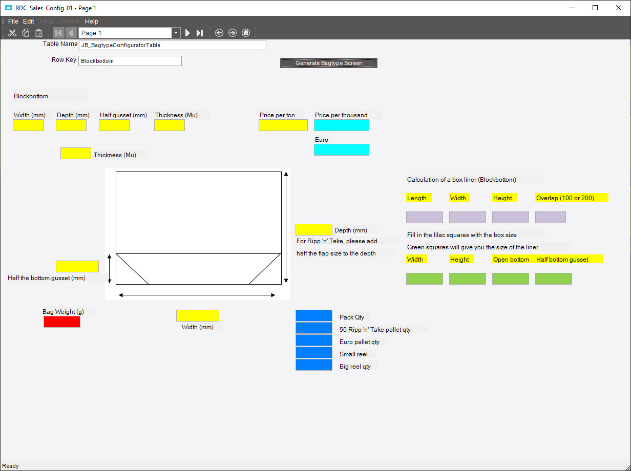

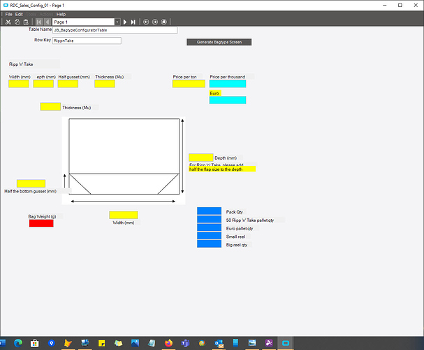

Once a screen design is selected from the configurator by the operator, using the PCLookup feature all the data for the requested screen is loaded in and fields are placed on the screen in the correct row, column locations and formatted as required…This works fine, with no issues.
Using Evan’s coding method of loading like inputs into C# Lists each existing input field is then loaded into the list and associated with a field in the Configurator Lookup table making all displayed inputs to be easily modified as the input control can be manipulated by referencing an element in the “input type” list. Effectively you manipulate the inputs by accessing them as a list element. The element number is held inan internal array which mimics the configurator lookup table but contains the list element number of the control it is bound to as opposed to the input name.

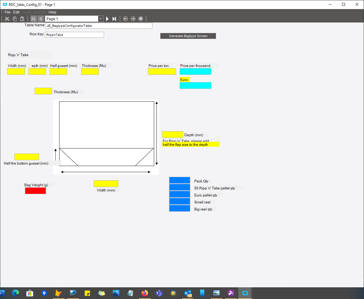

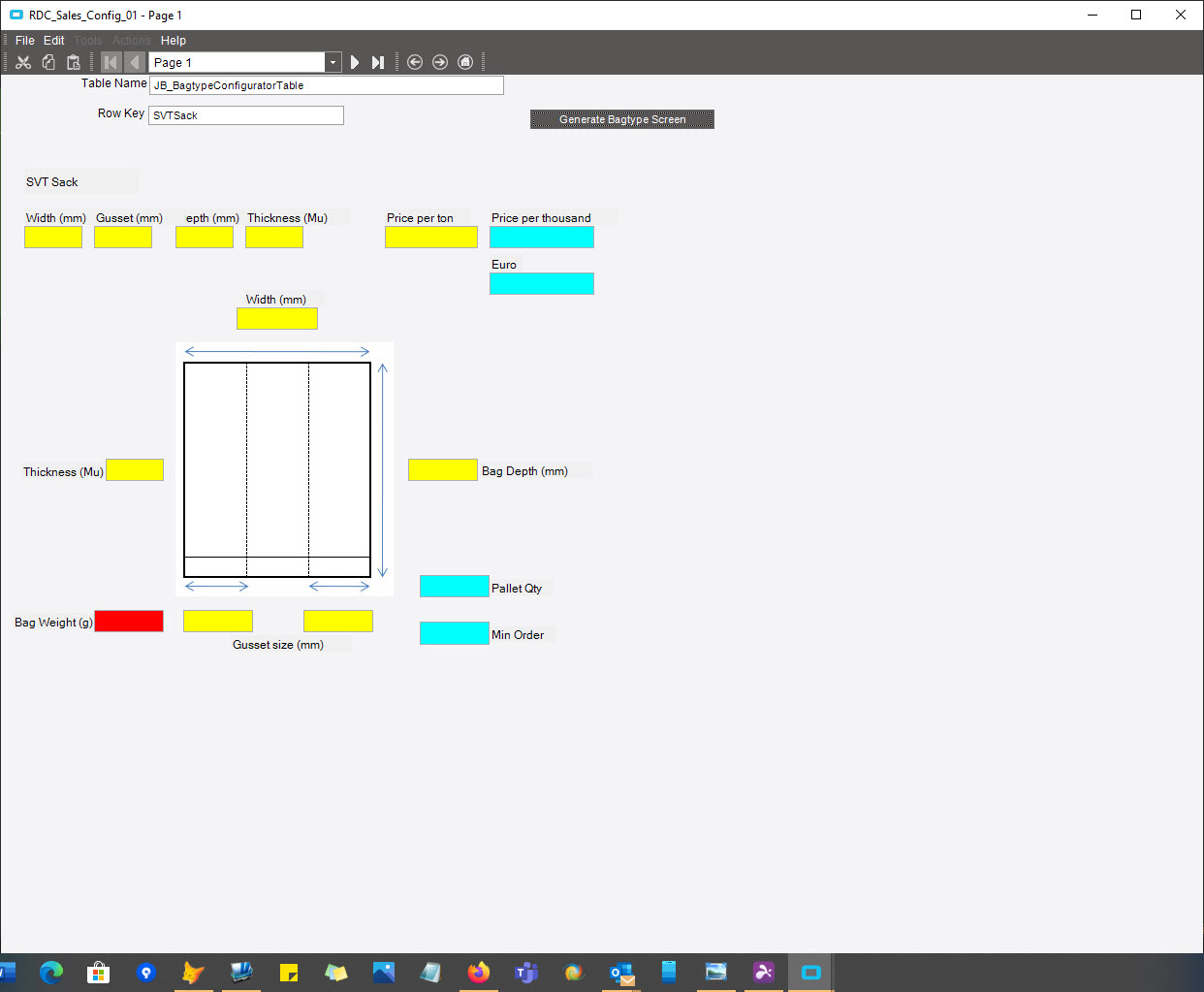

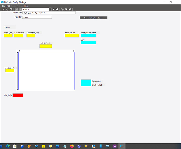

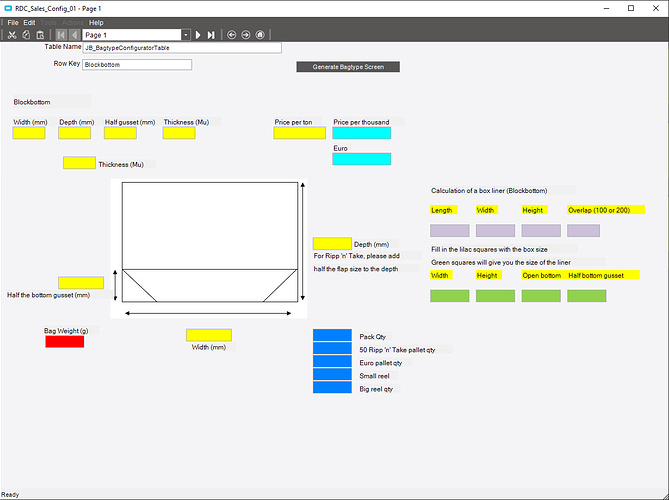

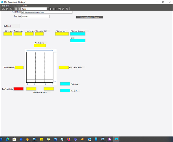

Hope this is making sense to you all. If not I can post some screenshots and examples of it in action for you to see along with anyone else who is interested. Data driving all input screens is something I have always done in C# projects as you generate the data driving software once and then can re-use it ad infinitum. Unfortunately the inability to use C# reflection in the configurator limits whet you can do to manipulate objects in the configurator but I have overcome this, as I said earlier, with some out of the box thinking.
