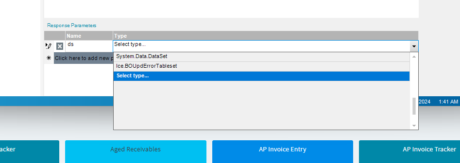

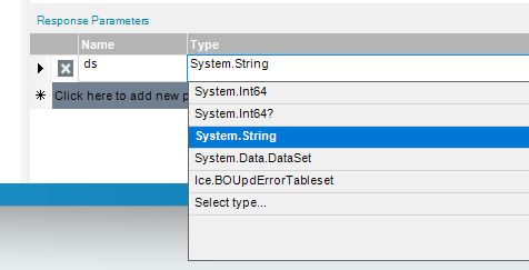

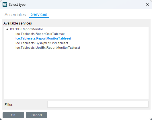

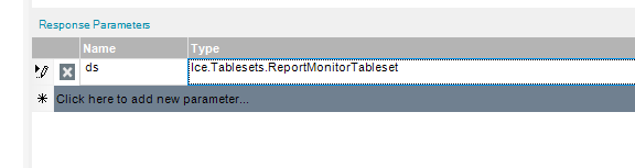

I’m asuming here you will want to define the argument/variable or signature variable to be of type ReportMonitorDataSet.
To do this when you go to select the type you will need to use the “Select Type Option”
The Service or assembly has to be added to the function library first…
I hope that helps.
