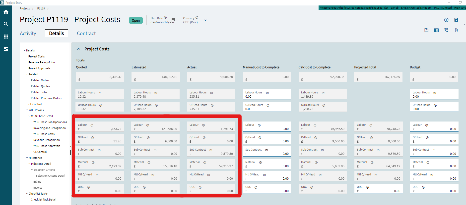

Within the Project Entry screen, there is a Project Costs tab showing total Quoted, Estimated and Actual costs. I wish to create BAQs to drill-down into the detail behind these costs, to show where they have come from. This is to help us determine why there is a variance between Quote/Est/Actuals on Projects.
Does anyone know what tables are used to calculate the highlighted fields? Via Field Help, the totals are stored in ‘ProjectCst’, but there looks to a process that calculates these totals, so I’m unsure where Epicor is getting its data from.
