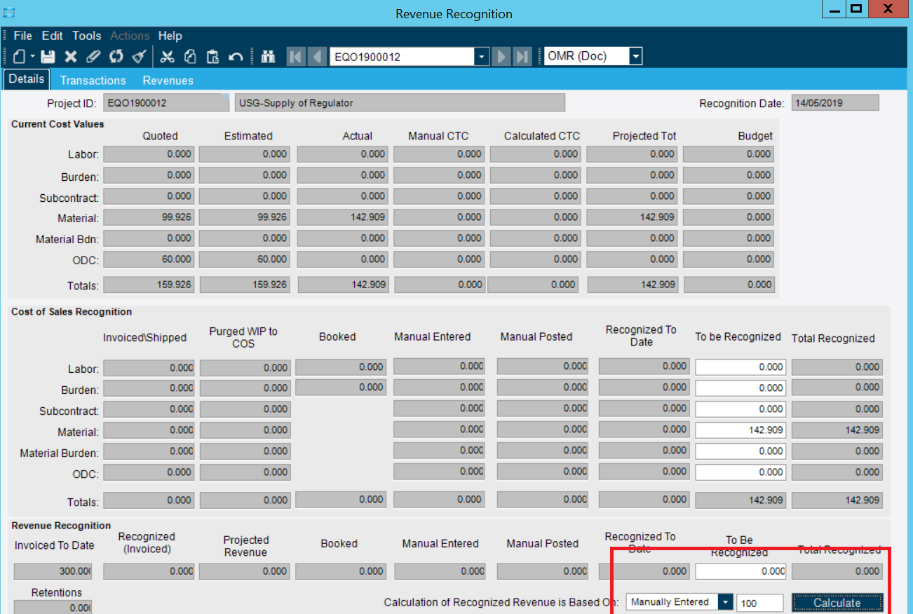

Project- Revenue Recognisation
Dear Experts, We are not able to recognize the “Manual Entered” revenue for some of the projects.
Please suggest, if anything is missing.
@Hari_Dutt,
Hello when you mentioned “Some Projects” Have you taken a look at the difference between projects that work and projects that don’t. Are the Revenue Recognition methods for both the project and the WBS phase setup correctly (that is is your company config allows revenue recognition at the phase level).?
To start, I’t just be comparing the setup of a project that works and a project that doesn’t. That’s all I have to offer I’m afraid. The last time I looked at project stuff was on 9.05.701 about 18 months ago.
Thanks Hally, for your support. I have compared with projects in which we are able to generate revenue reorganization & found order quantity was entered as Zero in SO.
