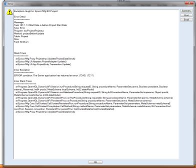

Immediate error message:
[/uploads/default/original/2X/a/ad8e5603dd299a3d63340f33bf8f037f1d8a7c51.jpg]
Detail of error message:
[/uploads/default/original/2X/9/948fa76f386123e5201014f249d8af10a3c861b1.jpg]

You may be able to read this; the error message details of:
“Task 18T-1.13 Start Date is before Project Start Date”
EPICOR-WBS-ERROR-SUMMARY
Your phase dates cannot be outside your project dates.
So StartDate<=WBSStart and WBSEnd<=EndDate.
I remember this getting tricky sometimes with the errors constantly popping up, but you just need to get the WBS dates within the start-end date of the project.
Edit: Try expanding the project dates outside the WBS dates first.
