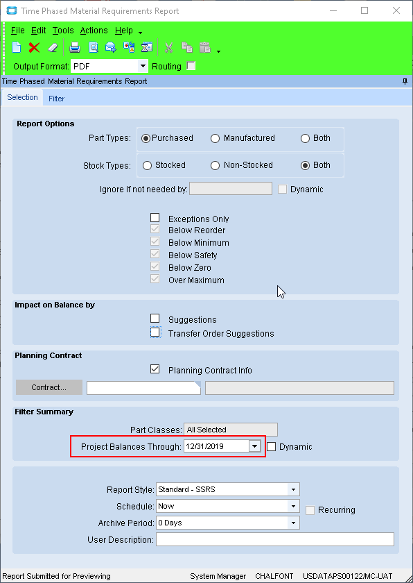

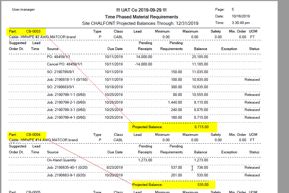

Look at the Time Phase Report. It might be overloaded with details, but it should combine the expected receipts and material issues, with the current inventory
Thank you Calvin. Unfortunately I need this information on all of the thousands of parts in inventory and I believe Time Phase can only be done on one part at a time. If it can be done on all parts at once it would work for me but I do not believe it can.
