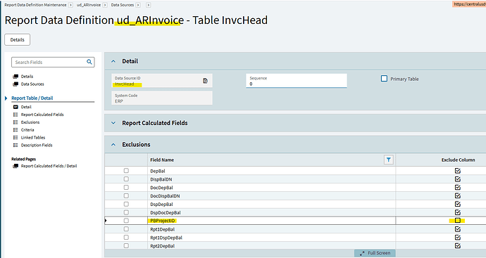

Yes, You need to ‘un-exclude’ the field in the RDD like so:
Open Your Report Style
click on RDD field and navigate to ARInvoice RDD
Duplicate the base to make a copy
Find PBProjectID and uncheck Exclude box
Save
Back on Report Style: set RDD to your new ud RDD
Save
Now you can modify RDL to add it to the Dataset SQL expression and Field List.
HTH,
Josh
