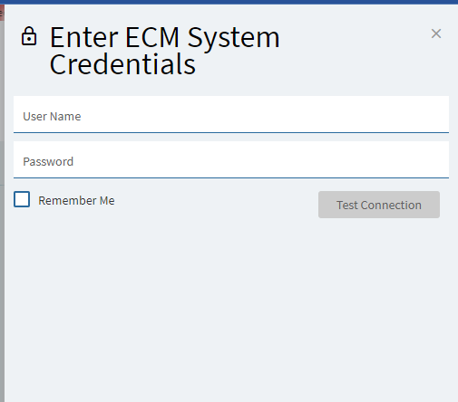

We have no problem attaching ecm attachments in the kinetic UI, but when we click to View the attachment, a prompt for ECM credentials pops up. I am so confused - the same ECM attachment can be viewed from the classic UI without a prompt. What’s up with that?

Well now support is telling me that this is NOT a bug, that we have to create an ECM account and have every single user log into ECM to be able to view attachments? Is this really true?
I can’t understand why an ECM login would be required to view the attachment but not to download the very same attachment. Make it make sense.
I think it is because it launches it in ECM instead of the native document format as opposed to the download. For right now we have them put in credentials and save so that it does not prompt every time.
Why would I want to consume an ECM license just to view a document that can just as easily be viewed in the browser? What is the value-add there? It’s clearly not for security, because they can already download that exact same document without providing ECM credentials. So there is no plan to fix this despite the PRB referenced above?
This is insane! A login was never required to view ECM documents before. So we’re supposed to license every user? I don’t think so.
