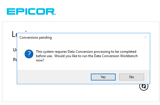

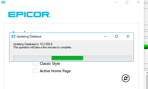

Typically after an upgrade like this, you will receive this error in the Epicor Admin Server untiil you log in to a client a perform the upgrade\data conversions
