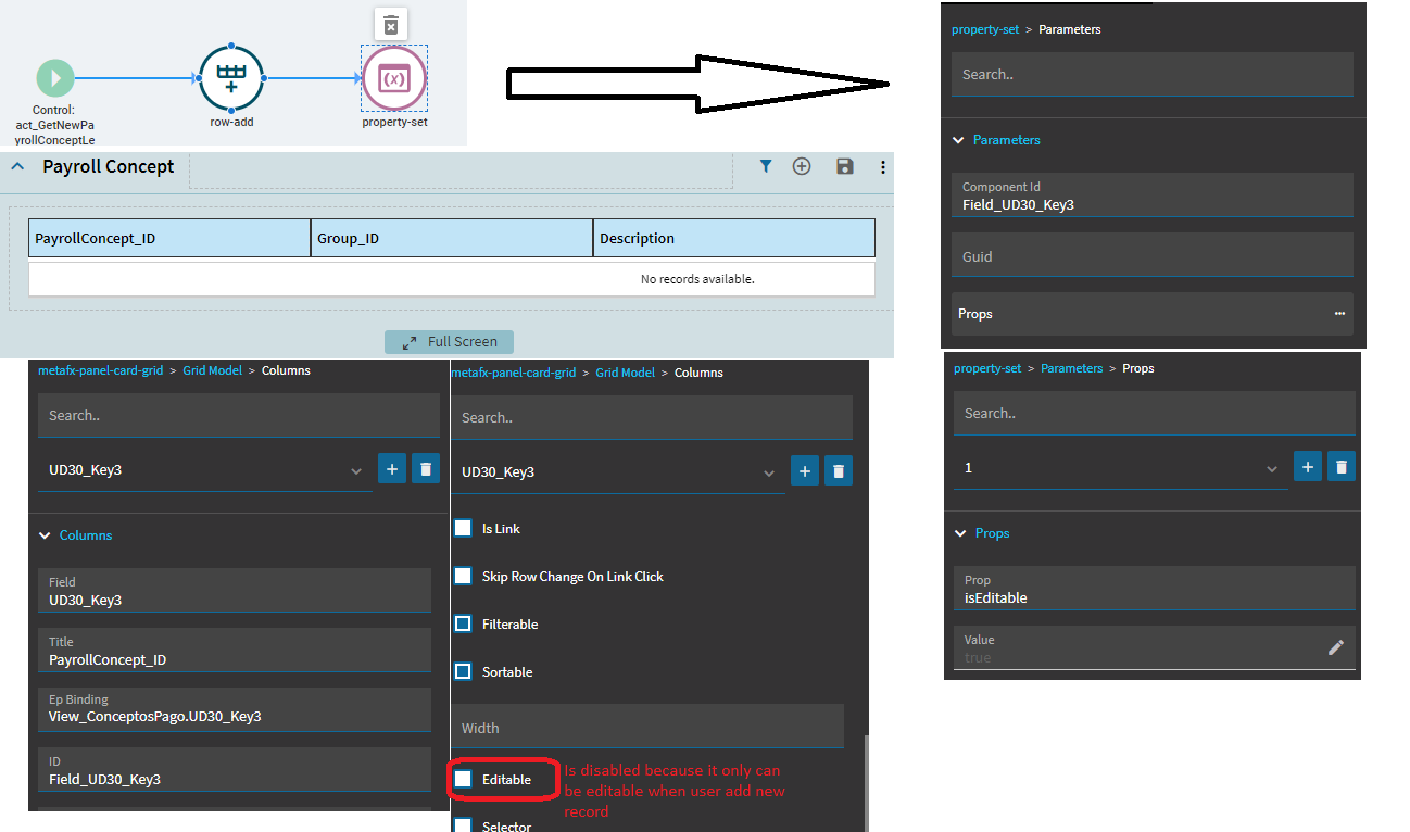

I need when I add new record, Key3 can be editable but when I try to change value, Key3 can’t be editable. The field is in a Grid and the grid always has the field as editable.
I need to change the property of the field to “non-editable” when the new record is saved.

I need create new record and then I need update only Charecter01.
The error is that the field remains editable and if the user tries to change the Key3 field, the system creates a new record without notifying the user.

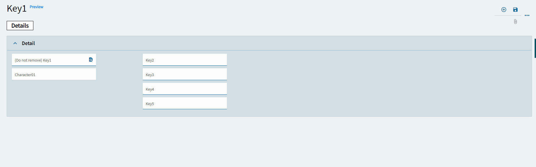

So, reviewing it myself, here are some points to note.
The textboxes are editable, but Epicor will not allow you to save. Is it dumb? Yes–yes it is, but I think your users would quickly figure out they cannot alter the Key data.
However, no matter what I did, I could not get it to generate a new record by entering data.

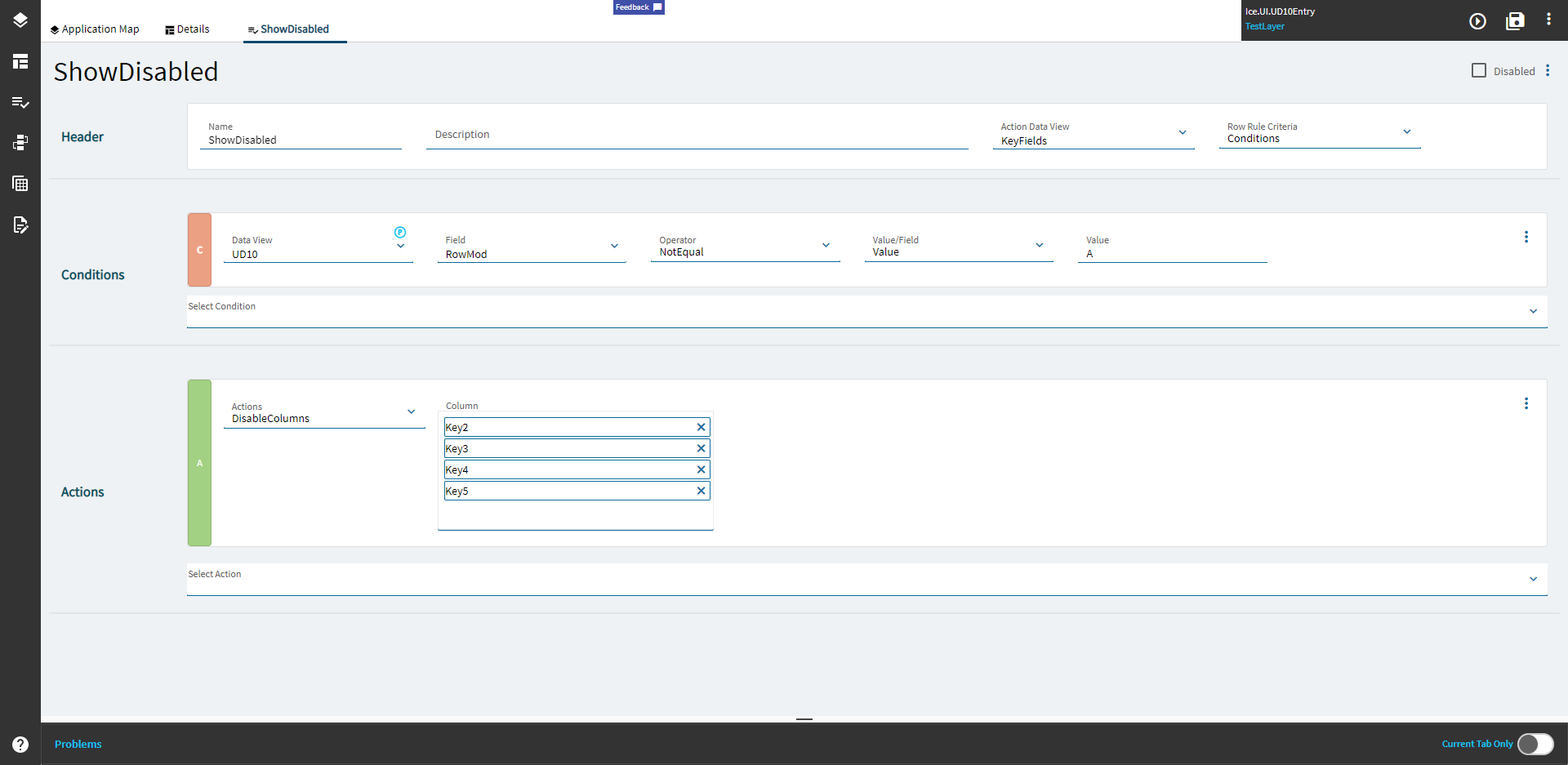

Any who, make a rule and disable the fields yourself when RowMod is not equal to “A” (add).
