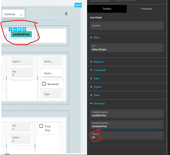

When creating a Kinetic event, might anyone out there know where to find a list of properties for the property-set action? Haven’t been able to track it down in the debugger.
Specifically looking to set a shape to the status of OK (green):

This is list property-set action on erp-shape (it can be dump with shortcut Ctrl + Alt + L in debug mode)
This is what i found for value status:
status 0 = OK
status 1 = Warning
status 2 = Stop
status 3 = Global
status 4 = None
