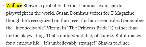

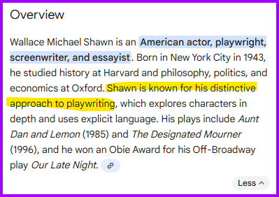

I read the other day that he is allegedly much more famous for being a playwright.
Maybe at Oxford :eye_roll: but here on Earth, he’s Vizzini.
Here it is - in a daily newsletter (of the news) that I read. At first I was sure it was a different person.
