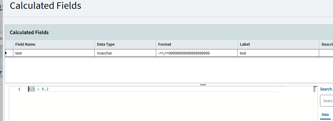

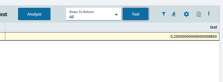

Here’s how to verify: Make a new BAQ. You don’t need to add any tables. Add one calculated decimal field, adding 0.1 + 0.2 and edit the format to show 20 decimal places.
Then run it.
So what, I hear you say. You’ll never format decimals like that in a BAQ. Okay, format the decimal to one place and you’ll be shown “0.3”. Right click that result, copy all or selection or whatever, and paste somewhere. That’s not 0.3 on your clipboard. Decimal values are being passed around as floats regardless of the displayed value.
Why does this matter? When a value that should end with 5 is incorrectly reported as /499999… and rounded to the nearest relevant unit, the rounding is wrong. Best case scenario is that exported work will lose accuracy due to rounding error exposure. Worst case is that the software itself is consuming float math. Currency is a decimal. Exposing the GL to float-caused rounding errors is not something any of us wants to experience.

0.1 decimal + 0.2 decimal should become 0.3 decimal, not converted to float at any point, but it is handled as a float because browser javascript doesn’t have a numeric object to hold a decmial.

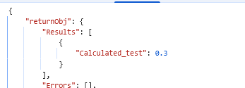

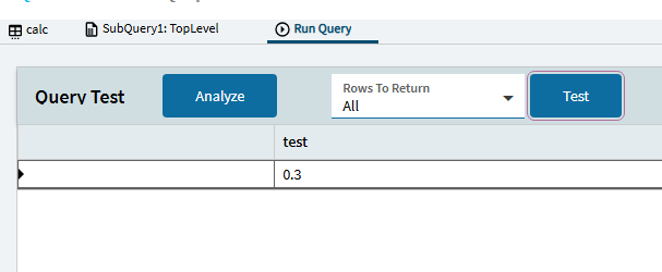

It actually works for me too. Maybe it was already fixed recently
No, it does not, I forgot to set decimal type.
Data is returned correctly from the server
