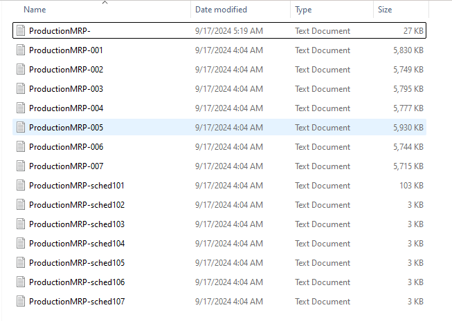

So, I discovered by accident today that even though I have 7 schedule logs shown below (all with today’s day on them), only one is scheduling. (Just look at the file sizes of the schedule logs.)
Apparently I have had MRP set to do finite scheduling for a while and did not know it. I sure never did that on purpose, but lo and behold, that’s how it was set.

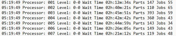

What’s the big deal? Well, this has been adding over 2 hours to MRP every night and I didn’t even think to look at the schedulers. I just thought it was slower. (Well it is - my BOM copy times shot up by a lot. But that was only half the story.)
I happened to notice that ALL of my processes would be “waiting for part” for 2+ hours each. I have seen 6 of 7 waiting for the one process to finish, but not ALL of them. I was baffled as to why they were waiting if everyone was done with level zero. It’s because they were waiting on the scheduler - not the processes.
And it’s all because MRP was set to finite scheduling.

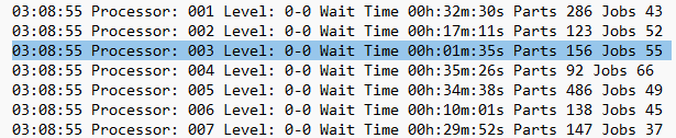

Confirmed. MRP ran faster by 2 hours and 10 minutes last night.
EDIT: This is more like it. Some processes wait longer than others, but at least one should have almost no wait time.
