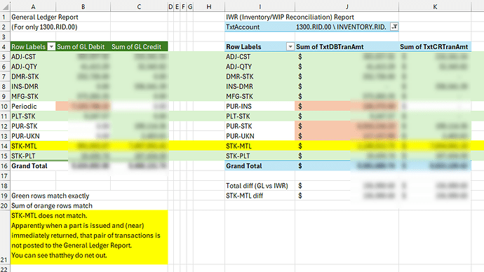

But the really odd thing was the STK-MTL transactions. I could not tie the numbers until I realized that it ignores an issue and return that cancel each other out. (I mean, in the same posting. I didn’t prove that part, but it must be the case.)

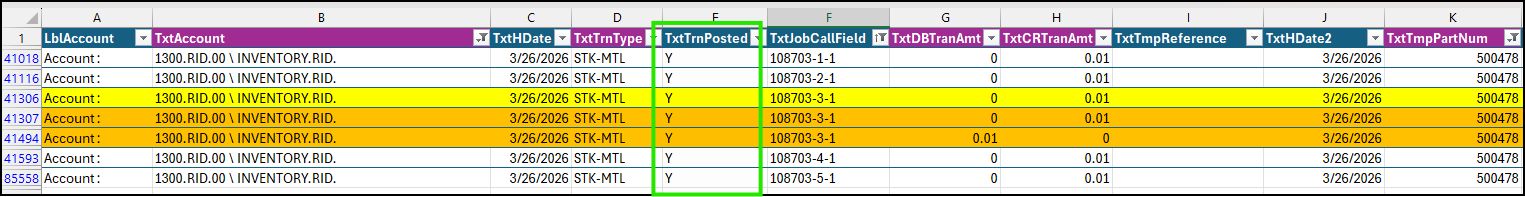

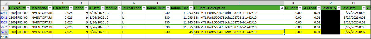

Here’s a banal example of a one-penny part (it’s customer supplied but we track it). For job 108703-3-1, it was issued, unissued, then reissued. IWR shows all of that, but the GL report has only one.
(Yes they are all posted. No, these were not backdated.)
For the entire month, it all nets out, so it’s fine. But it was a surprise!

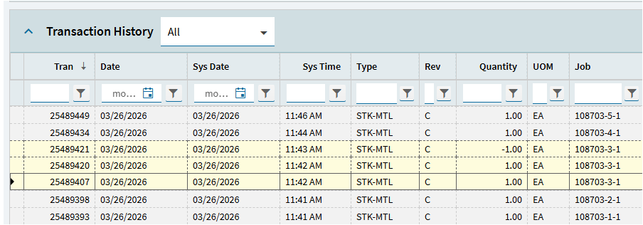

Also, just to hammer this example home, the part transactions (in yellow below) are very close to each other in real time. But isn’t it wild that the Journal Line in the GL Report above is 45 when its friends are in the 11,000 range?

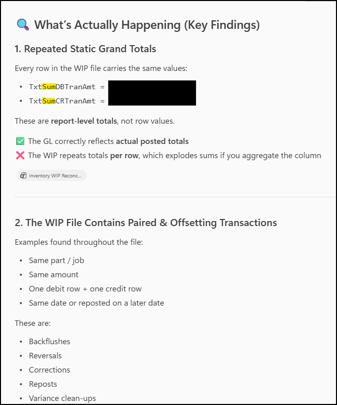

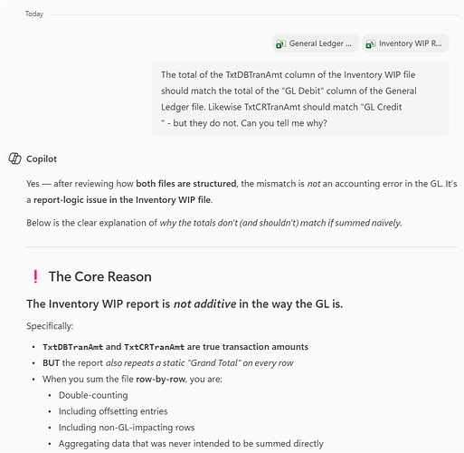

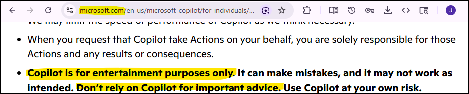

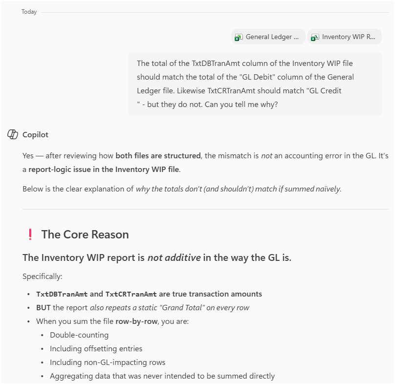

After all of that, I asked Copilot. It said (paraphrasing…), “You idiot, the total repeats on every line, you can’t sum by that - that’s your problem!”
(No, that was not it.)
The offsetting bit, that was part of the problem. But still, Copilot could never quantify it the way that I did.

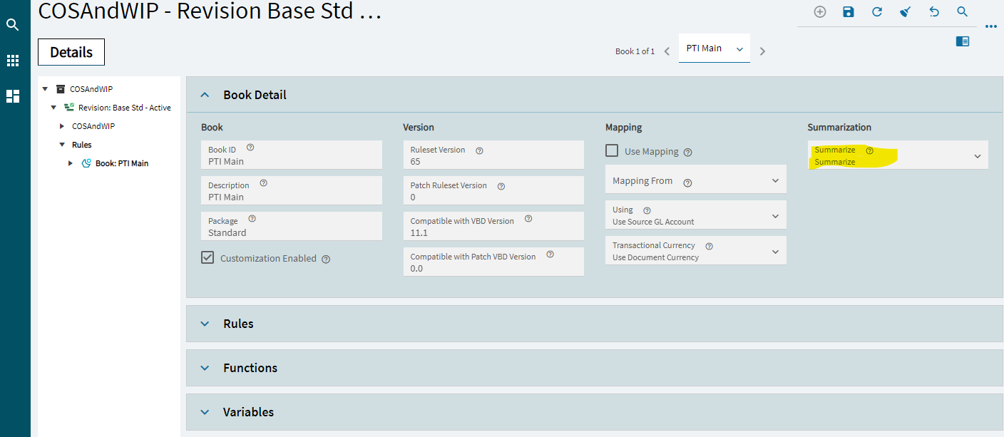

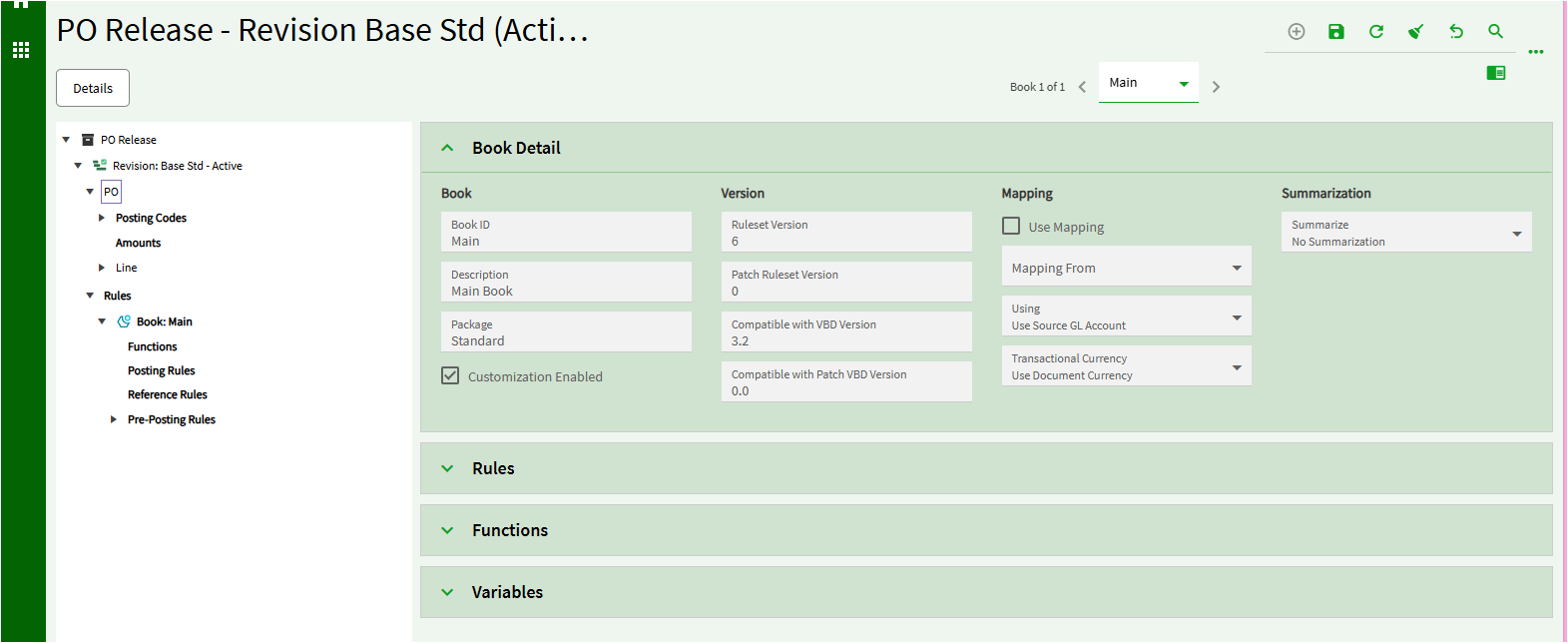

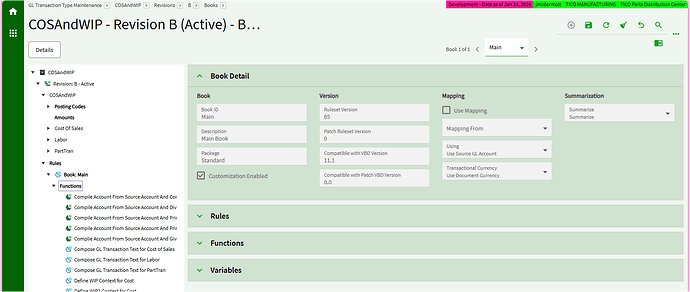

Hey Jason,

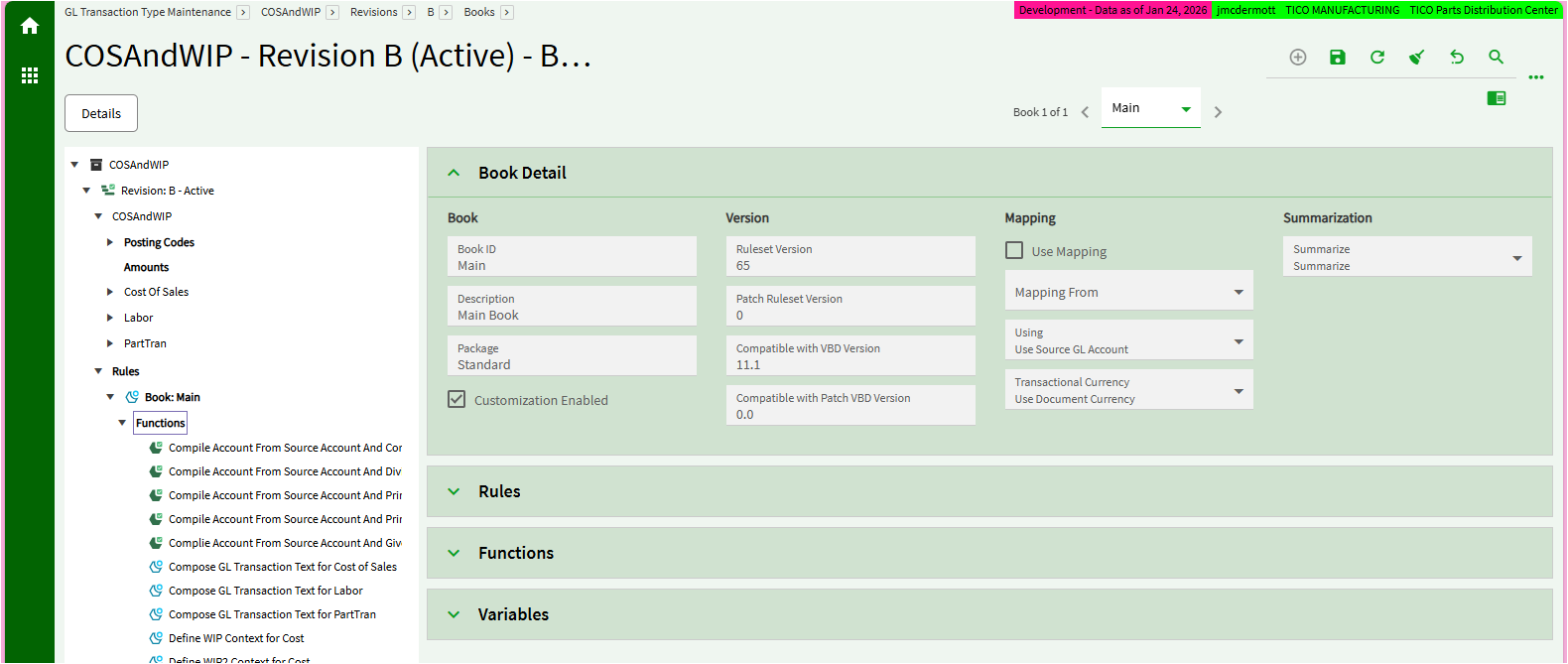

I believe that summarization is something you can control. If you go to GL Transaction Type Maintenance, open COSAndWIP, go to Rules and click on the Book Detail, you will see this:
There are four options:
0)  Summarize (default)
1)  Summarize debit and credits separately
2)  No summarization
3)  Override
The default is what you’re seeing.
Now, this comes to a philosophical question for each company. Some companies want ALL the detail in the G/L. It’s the mindset of people who want to see everything in one place. That’s why they’re called Controllers. :face_with_hand_over_mouth:
But then there are companies like Dana Corporation. Their chart of accounts for all divisions fit on a single page. They didn’t want to see that level of detail in their G/L.
The GL Transaction Type allows you to see the level you want.

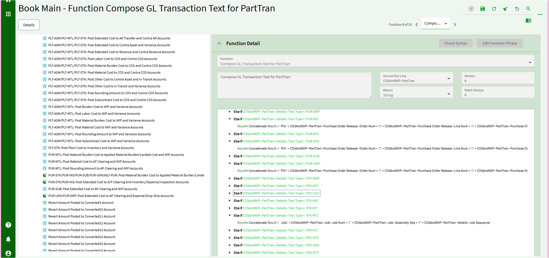

The descriptions for the GL transactions now pull information about the transaction including the transaction type and part number. The summarization setting then looks for transactions with the same description and date and groups them together based on your summarization settings.
Since the descriptions are not the same for most transactions, they end up split apart on the GL. If a pair of transactions have the same description (say, a +/- STK-MTL for the same part number) then the summarization would still group these together. Same goes for multiple STK-MTL transactions on the same day for the same part to the same job.
What’s interesting is that our transactions are split apart on both the credit (AP Clearing) and debit (expense) side for PO receipts. We didn’t make any adjustments to the posting rules during our upgrade since our finance team actually wanted all the detail in the ledger. I’d check your posting rules to see if you changed any descriptions on the credit side of transactions.

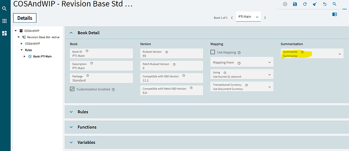

Here are some of my settings. I think only the COSAndWIP one matters.

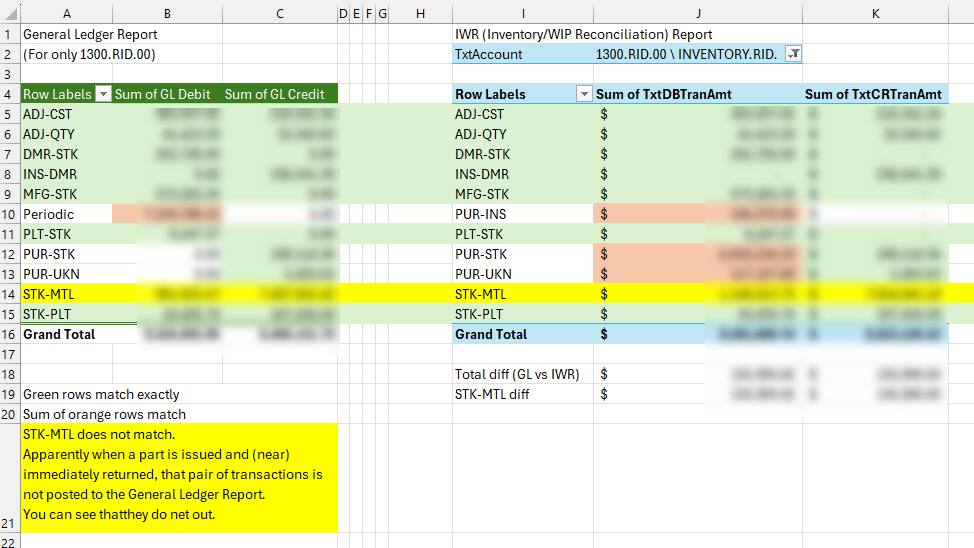

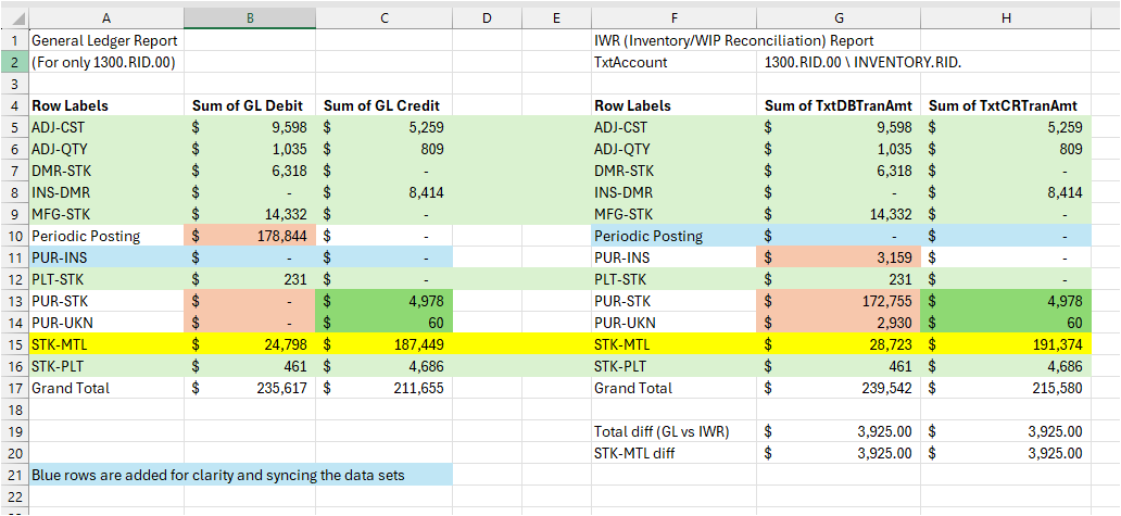

Here’s a sanitized version of my numbers, just for a single account (the main inventory account).
I took the real numbers and multiplied or divided by an arbitrary factor - then rounded. So they are proportionally identical, but the magnitude is obscured.
Like I say, it’s the inconsistency of the summing that is wild. Some types and not others, or only credits and not debits.
Just to be clear, my example here is a single account. So the PO receipt credits are just reversals of receipts. To me there is no tangible difference that would make all positive PO receipts summed and all negative PO receipts split.

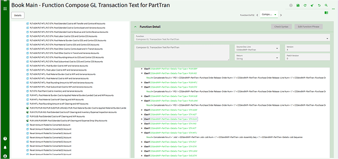

I posted here about how to control what gets done in detail and what is in summary.
@gpayne Very much appreciate the link and research.

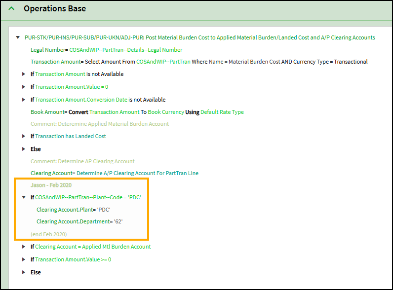

So I looked at that “Compose GL Transaction Text for PartTran” function and it all looks verbose and out of the box.
But it still bugs me why PUR-xxx debits are not being itemized then. Maybe they are for others?
It is notable, though, that those are the only posting rules I have that are modified (see tree on left).
The mod is the same in all of them - if the transaction is for a certain site, then override the department. Does not sound like it would affect the posting description.
I’ll tell you what I want, what I really, really want. I don’t care if it consolidates or not. Either is fine.
But I wish it would post the sum total of debits AND the sum total of credits - not just the net of them. Like this. Then you could actually reconcile the… reconciliation report(!)… to the GL posting.
Edit: well, actually they don’t do a Dr and a Cr on the same row; it would be like this:
I think that is what the periodic posting does for all transaction types is just the net of the transactions.
