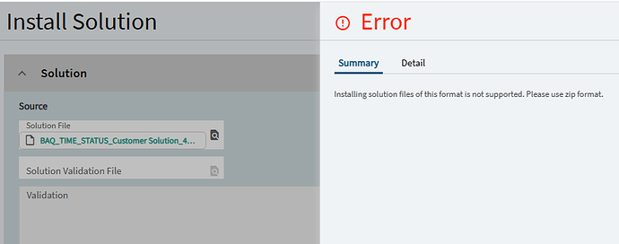

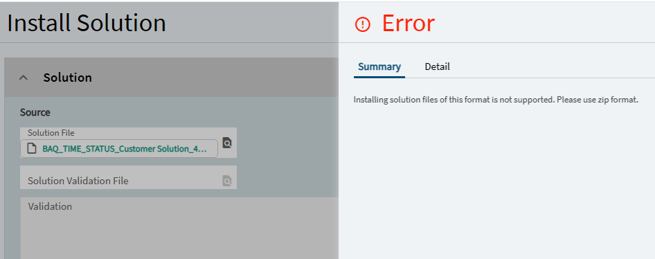

I only learned of this from this thread. If you try to import a CAB file into Solution Workbench in Pilot 20205.2.14 which is Linux you get an error that the format is not supported - use Zip format, per screenshot below.
