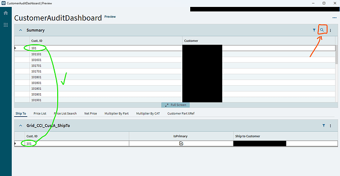

Top grid is “Summary” the Publishing grid.
Bottom one is “ShipTo” the Subscribing grid.
In the ShipTo grid I have one BAQ Where List item.
Column: Customer_CustID
Condition: =
Value: '?{Summary.Customer_CustID}'

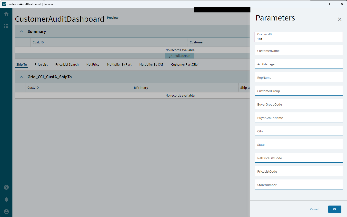

When it first opens, the baq parameters open up, I fill them in and click ok.
This 1st attempt the pub/sub link works great! Cust IDs in both grids match.

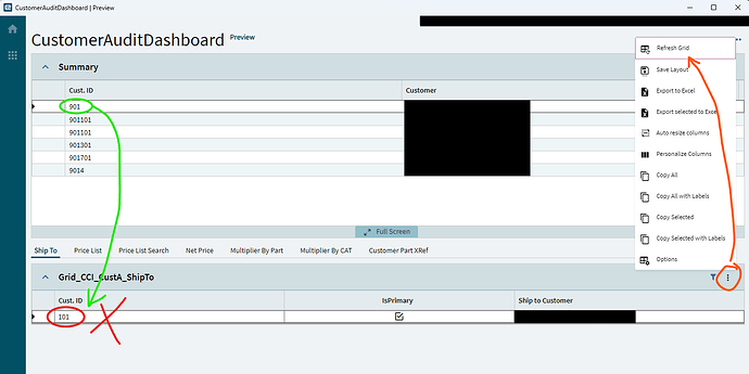

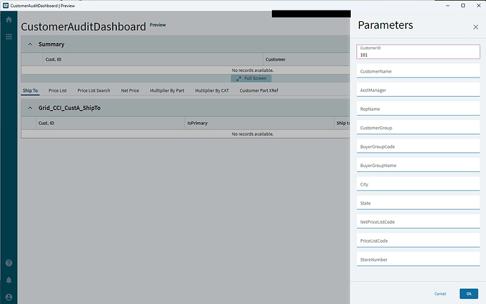

Then I click the search icon which uses property-set to invalidate the summary grid, triggering the parameters (of the publishing grid) to open back up.

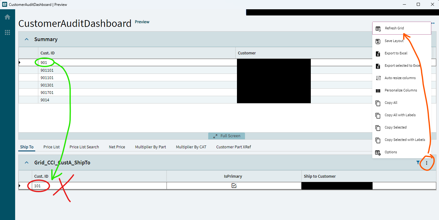

I fill in a different Cust ID and click ok, but this time the subscribing grid doesn’t change.
Only manually refreshing the lower grid will make the two grids match again.
