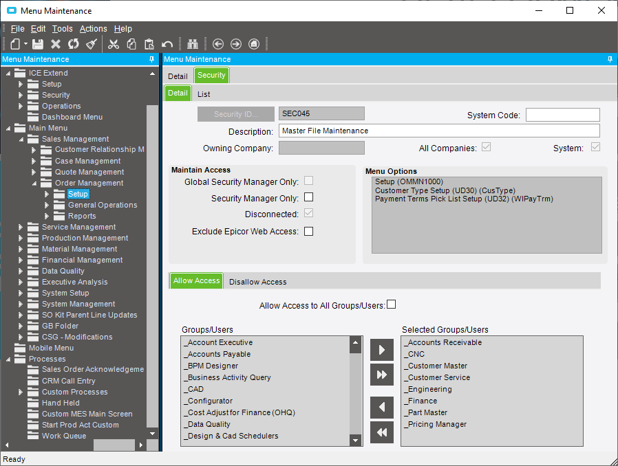

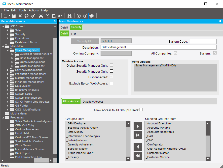

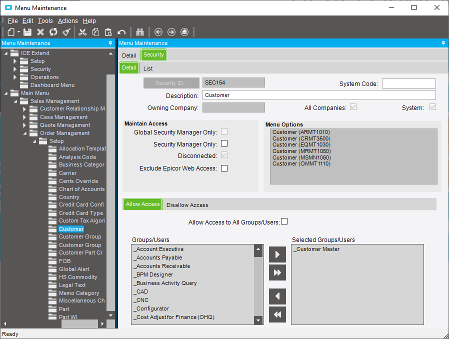

So, here’s an example of our security setup on each menu leading down to the Customer Master.
In order for this to work, you need to remove the “Allow Access to All Groups/Users” checkbox on everything and only allow the security groups that you want to have access to.
Alternatively, if you’re doing it for this one “Customer” login, you can go through the menus and set it to Disallow on everything except the ones you want them to have.
