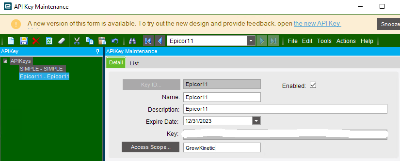

I have built the rest connection a little differently because we are using SSO but here is what I have done.
Presumably you are passing an API Key and not passing it in blank as per your code snippet?
var restClient = new RestClientBuilder().SetAppServerUrl(this.oTrans.CoreSession.AppServer).SetCompanyId(this.oTrans.CoreSession.CompanyID).SetDefaultApiKey(ApiKey).SetIsSingleSignOn(true).Build();
I took that code snippet verbatim from the Epicor Help – Calling Functions from Custom Code. I do an Epicor Application Event Log and it is triggering the Function, but something else is wrong. Whether I specify a blank API Key or this one in API Key Maintenance. I still get the error.
