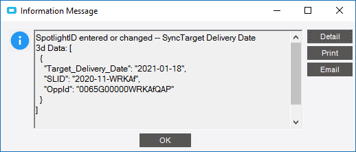

Thanks! I still got to be missing something I tried your code below. By chance do you have more of an example --especially one not using WebClient since it’s going away? I still get the full data set but the tgtDate still doesn’t want to display. I’ll try to beat my head on this tomorrow. LOL
Per the MS doc, Quickstart: Send a search request to the REST API using C# - Bing Entity Search - Azure Cognitive Services | Microsoft Learn I tried using HttpClient client = new HttpClient(); but Epicor did not like it. Though, we’re on 10.2.600.x for now.
Bad code below, why you no work?!
  using (WebClient wclient = new WebClient())
    try
      wclient.Headers.Add("Ocp-Apim-Subscription-Key", key);
      string uri = host + path + query;
Debug += Environment.NewLine+" 3b :";
      dynamic response = wclient.DownloadString(uri);
Debug += Environment.NewLine+" 3c :";
      var parsedJson = JsonConvert.DeserializeObject(response.Content);
Debug = "3Data: "+ parsedJson;
      var tgtDate = parsedJson.Target_Delivery_Date;
Debug += tgtDate;  //Does not display anything

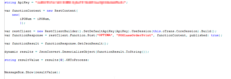

Hi, it’s a form customisation, here’s the code, I am hoping it is something daft I have missed?

Now I get an error when running the code. I put the result into a message:
Error from the code is
‘Newtonsoft.Json.Linq.JProperty’ does not contain a definition for ‘OKToProcess’
Hopefully this is easier to solve due to me being a noob to working with REST API and JSON data :blush:
I’ve never tried to do REST on a form. Could you trigger this REST call via a BPM by chance instead?
try just results.OKToProcess
That worked, many thanks for the help.
