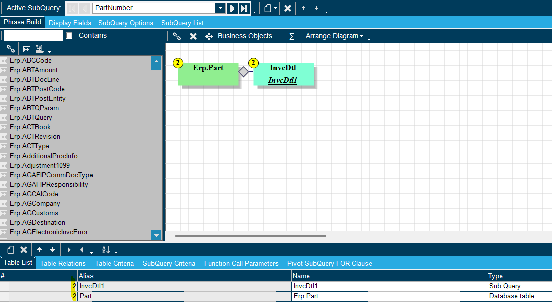

I’m getting an error:
Windowed functions can only appear in the SELECT or ORDER BY clauses.

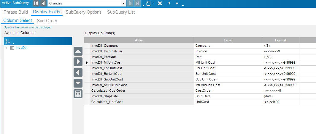

We don’t used the LbrUnitCost, BurUnitCost, etc. I’m just capturing InvcDtl.DocUnitCost.
My formula:
Row_Number() over (partition by InvcDtl.PartNum,(InvcDtl.DocUnitPrice)
order by InvcDtl.ShipDate Desc)
First, is this formula formatted correctly?
In K2024.1, I have no DocUnitCost nor UnitCost. I had to add up the components.
What does the error mean, what is it referring to? The calculated field? Something not joined properly? I don’t know where to begin to look.

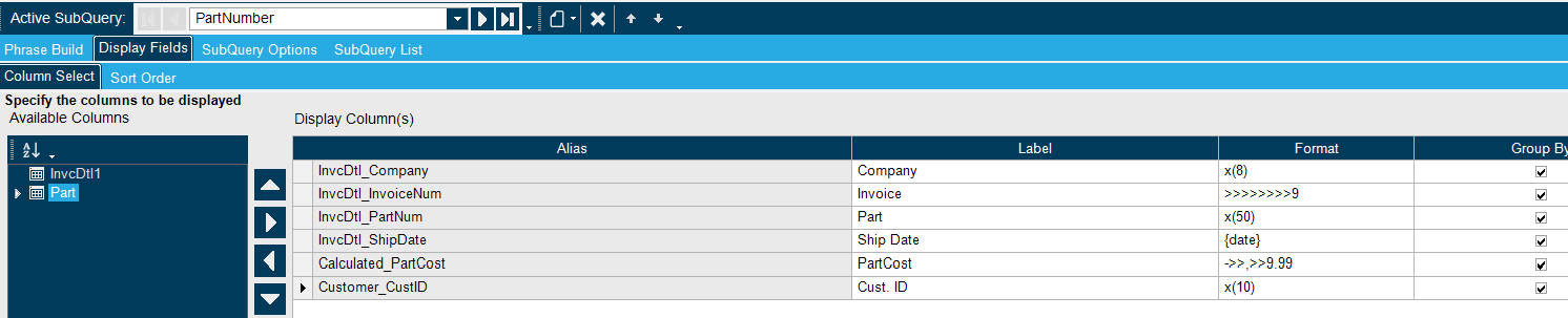

Got it…I was doing a “Group By” in the Subquery. In my investigation it said to NOT do a “Group By” in the Subquery and Voila! It worked!!!
