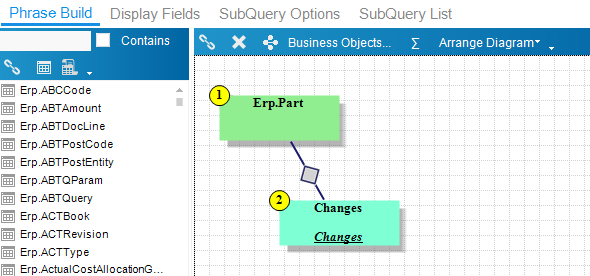

OK, InvcDtl it is. Create a BAQ with the Top Level query (Main) with Part Number.
Create an Inner Subquery with InvcDtl (Changes). I used Parameters to select the date range.

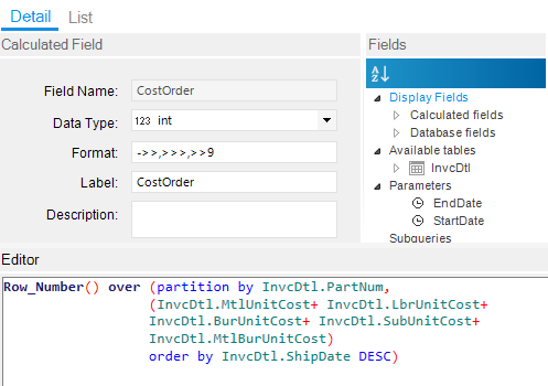

Create two calculated fields. The first I called CostOrder:
What this says is for every part/cost combination write a row_number. I ordered it by ShipDate Descending. So, for the latest date for the part/cost combination, it gets a 1, the next SAME part/cost combination will get a 2, the next SAME part/cost combination with get a 3, and so on. When the part/cost combination changes, it will go back to 1 and start over.

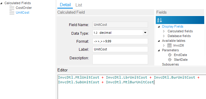

For convenience, I created a unit cost calculated field too:
Link the Changes subquery with Main

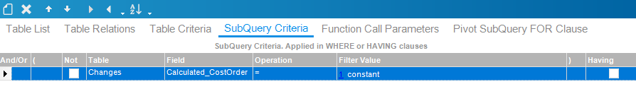

In the SubQuery Criteria, select CostOrder to be 1.

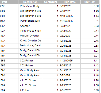

This should give you each time the part changed cost. This is rounded to 2 decimals, so there may be some duplicates due to rounding. However, you’re interested in the most recent change, but you should be able to get there from here.
